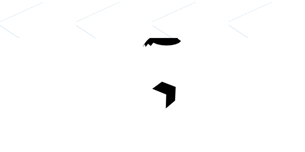

I posted this issue during a9. here is a link to the example. You will see that the AO channel shows half has a normal render, then at the top half of the image is small tiled images
download/file.php?id=51270
note that this is when using the batch render script or () saving as layered exr. it works fine with png however.
here is one example of the roughness pass.

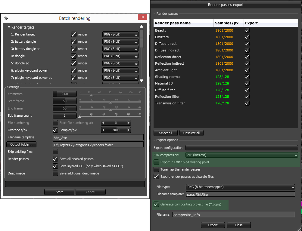

by adding the full flexibility to the batch render script, I am talking about all of (render passes export) features
the missing features are:
exr 16-bit and generate compositing project file
also compression options are not available
abstrax wrote:

Also, I hope to see more flexibility in the batch render script such as integration of the render pass exporter.
Again, what exactly do you mean? Multi-layer export is already available in the batch render script.

gah5118 wrote:I posted this issue during a9. here is a link to the example. You will see that the AO channel shows half has a normal render, then at the top half of the image is small tiled images
How do you display / use the layers of a multi-layer EXR? Some of the passes (like Z-depth, AO, roughness...) are stored as greyscale layers, i.e. with only one channel each. To me it looks as if your application tries to load those layers as RGBA layers...
I see. Thanks for the info. We will add these options to the batch render script.

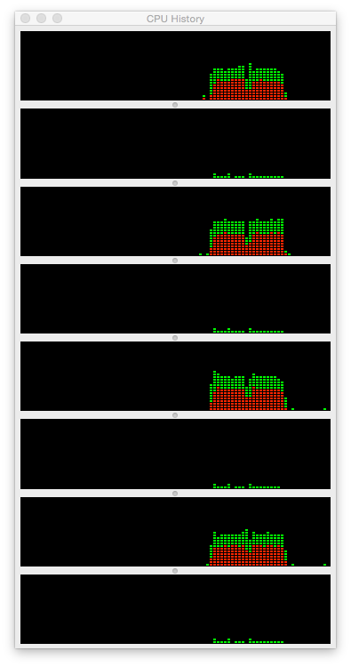

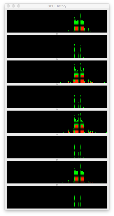

abstrax wrote: [*] Reduced the geometry compilation times on OSX and Linux. It's still a little bit slower than on Windows, but not as much as in the previous versions. Any further improvements would require some major changes in the geometry compilation code, which we plan to give a try some time after 3.00.
Marcus, thank you very much for your support on this issue.
I can confirm that compilation times on OS X are better with this version. I can see 2X faster performance on the same test scene and hardware I used before. It's great to see this improvement already in 3.0 even if it's still slower than Windows version.
Also, great job on so many other improvements and features in V3!
Can't wait for May 15th :)
CPU usage:
Version 3 alpha 1
Verision 3 alpha 10
Regards
Milan

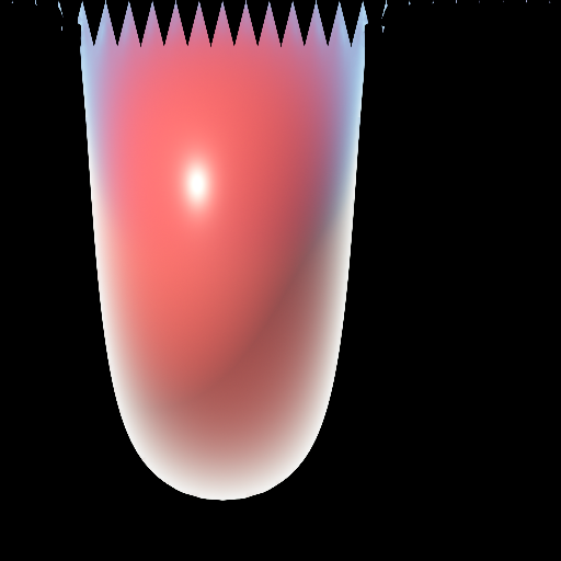

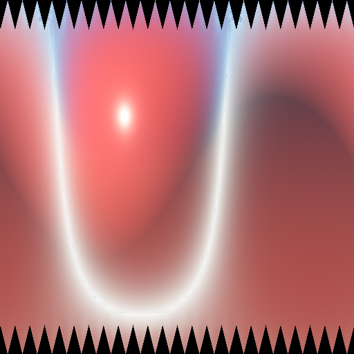

funk wrote: Image
Hi funk,
Thanks for your help. We've fixed the issue with backfaces in baking position-dependent lighting. This is the output you'd be getting now with Octane for the example you shared.
Also, the terminator curve is now soften so this is what you'll get when using backface culling.
Hope that will help.

Wow thanks Mojave! It actually looks better than modo's directional bake. Looking forward to trying it out.
