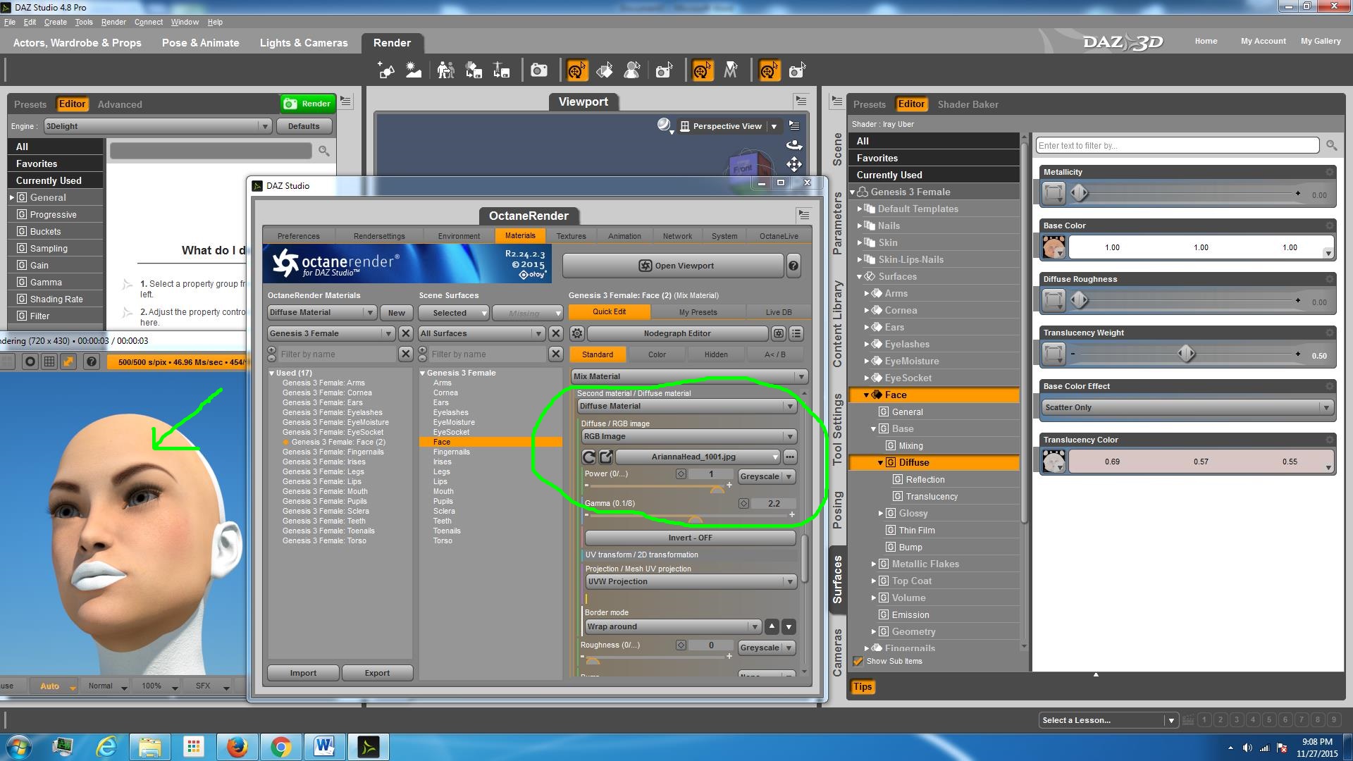

Just an update on the new-problem with Iray mats and the white characters, like Arianna
Here is how to render properly as a workaround (may be of use to resolving bug also)
Using the Face material:
Comes into OcDS as a Mixed Material with Diffuse having 'RGB Color' of White
Change Mixed Material header to Diffuse, then change 'RGB Color' to 'RGB Image' and load an image
Using this method it doesn't appear you need to tweak anything else, such as amount, power, etc.

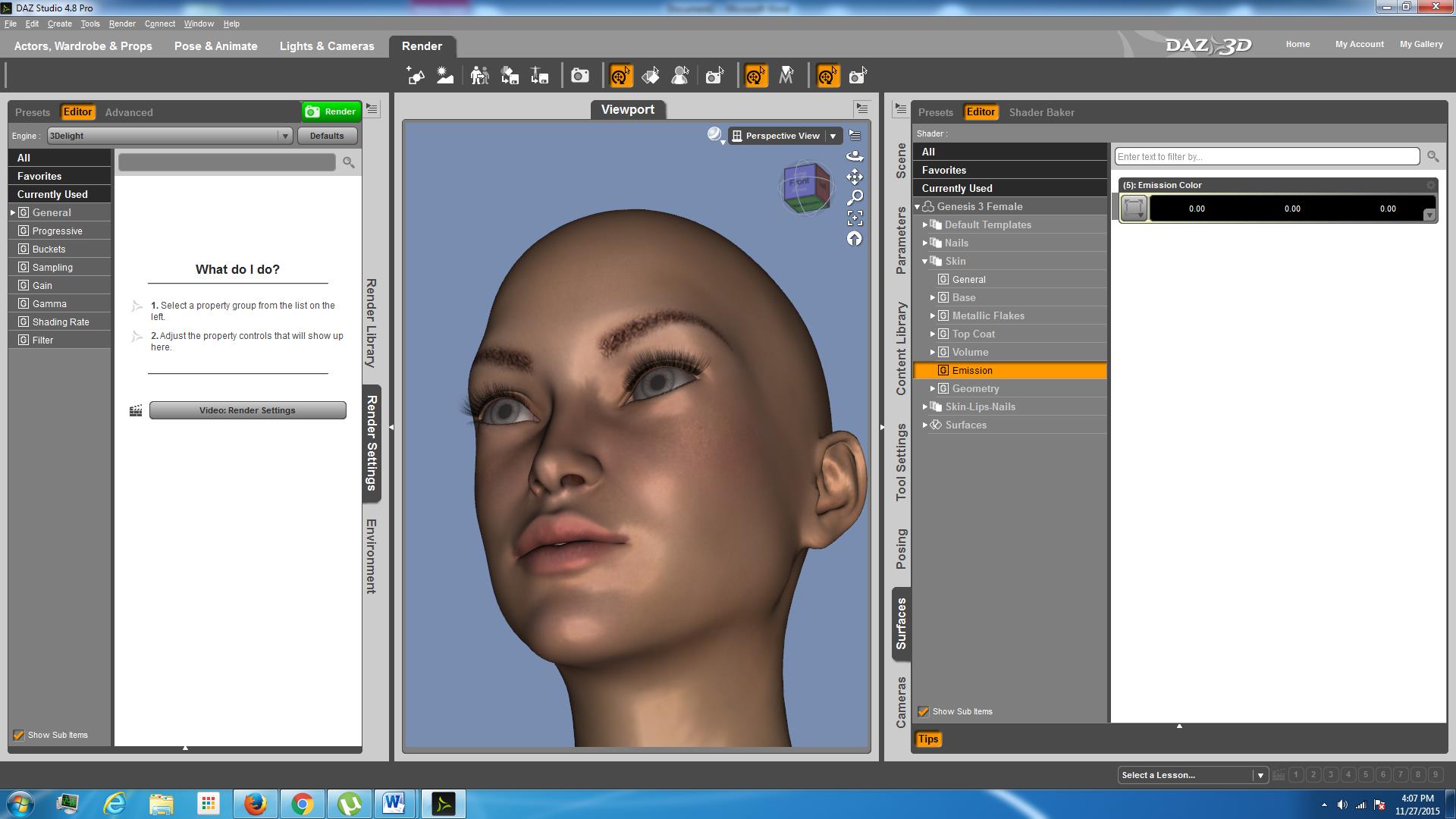

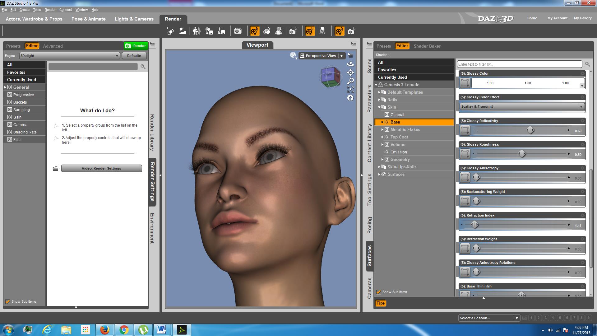

Can you pls post screenshots of all the variables in the Surfaces->Skin panel for Arianna - and I will find out why the material conversion is not working.

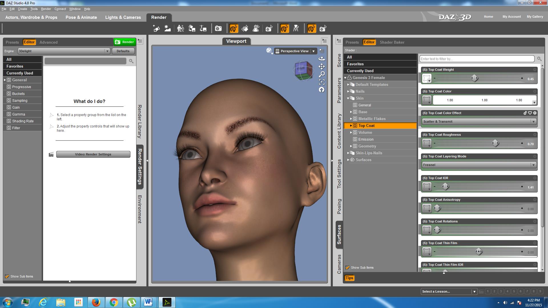

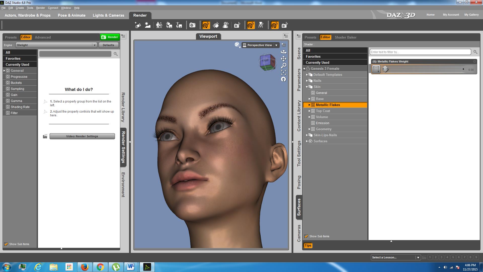

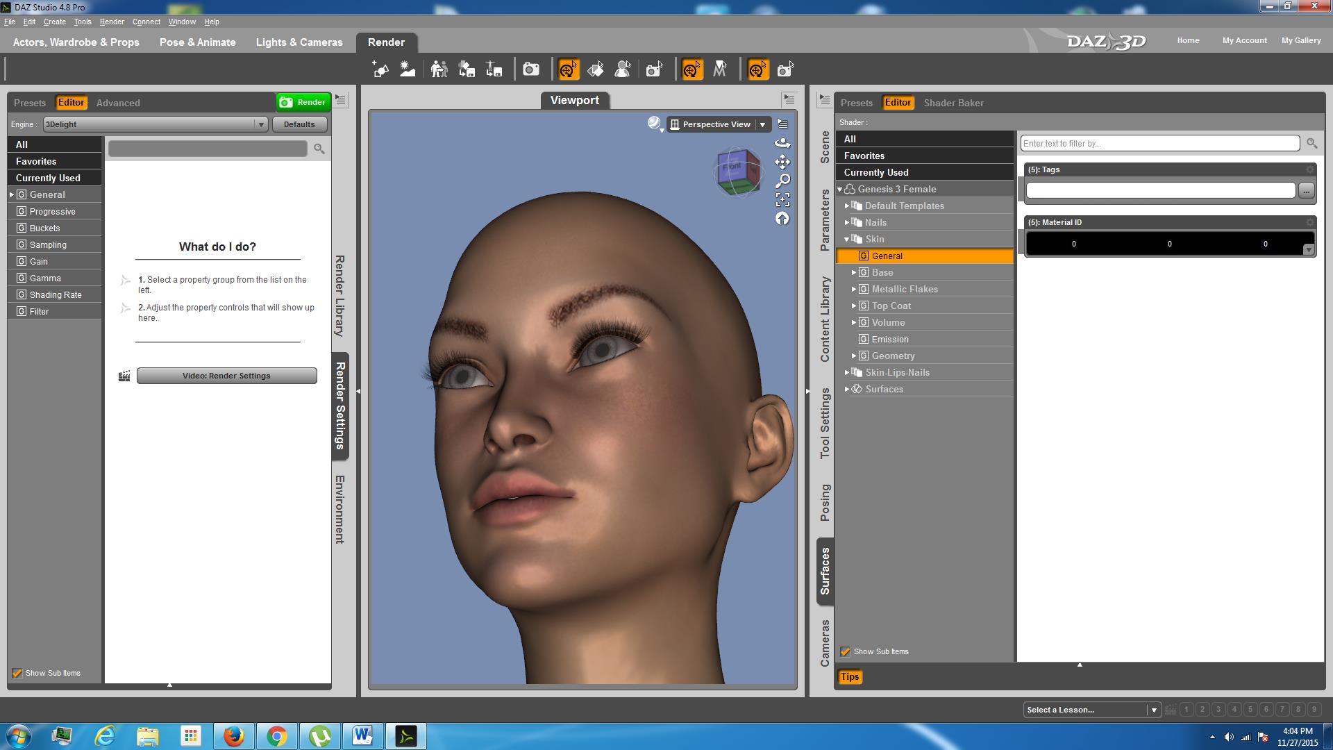

1 of 11 - General
1 of 11 - General

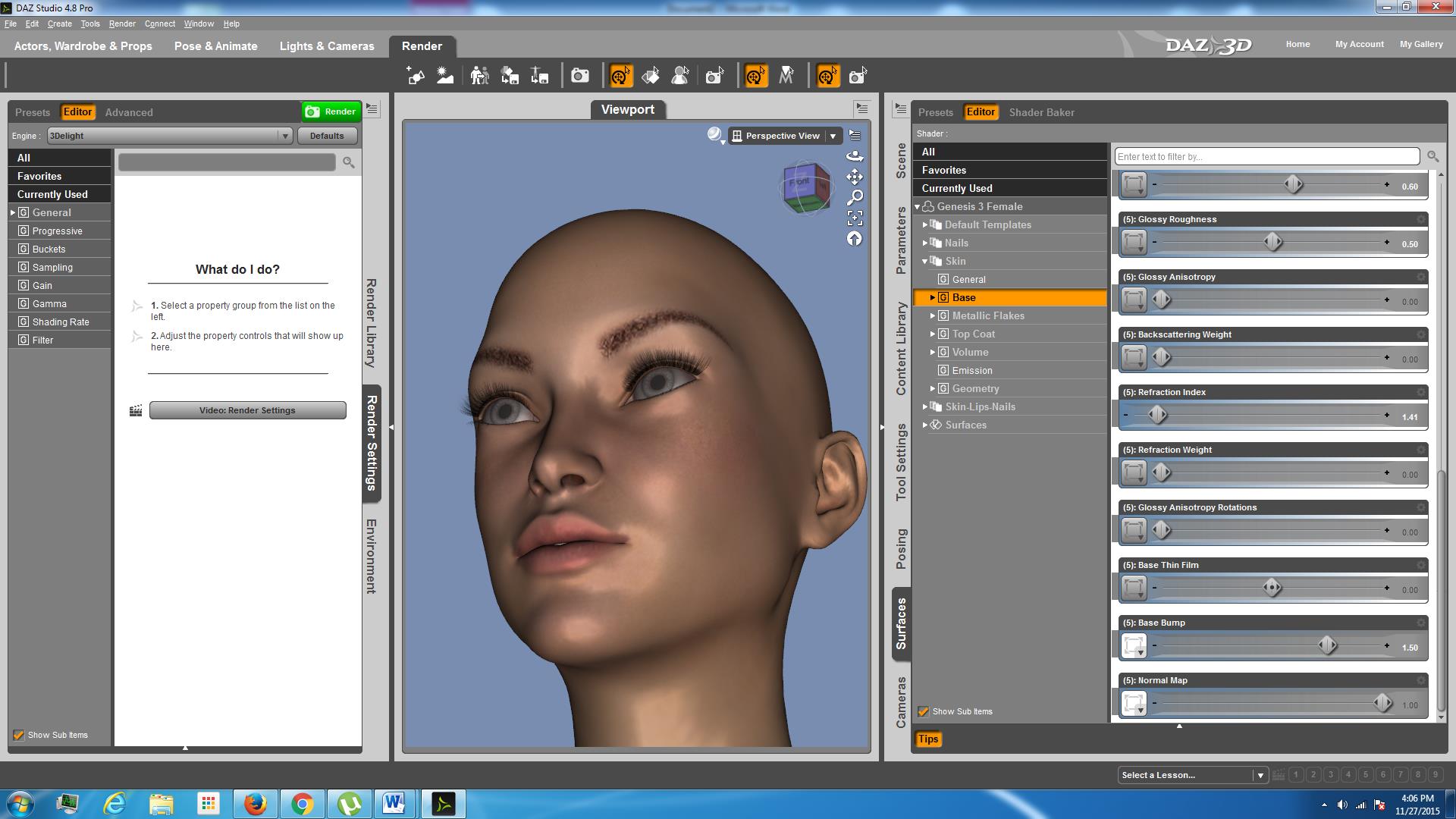

2 of 11 - Base 1
2 of 11 - Base 1
3 of 11 - Base 2
3 of 11 - Base 2
4 of 11 - Base 3
4 of 11 - Base 3
5 of 11 - Metallic Flakes
6 of 11 - Top Coat 1
7 of 11 - Top Coat 2

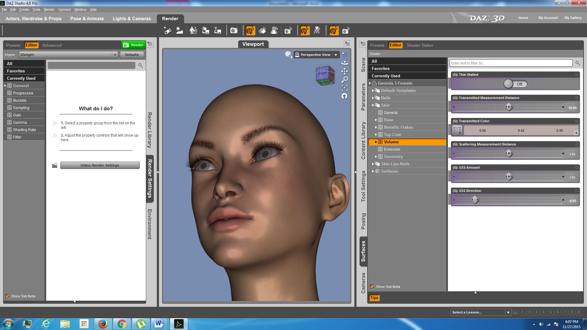

8 of 11 - Volume
8 of 11 - Volume
9 of 11 - Emission
9 of 11 - Emission
10 of 11 - Geometry 1
11 of 11 - Geometry 2
Let me know what else we need, thanks!
That's for posting those screenshots. I was actual after any one of the Surfaces->skin materials. In particular - I need to see the Property which contains the diffuse map. My apologies for not being more specific.
Paul
Notiusweb
Posts: 1285

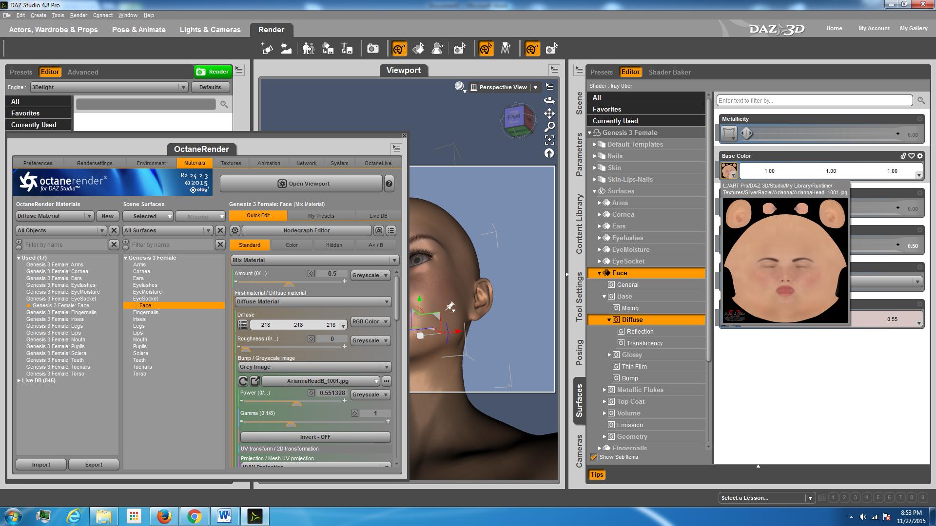

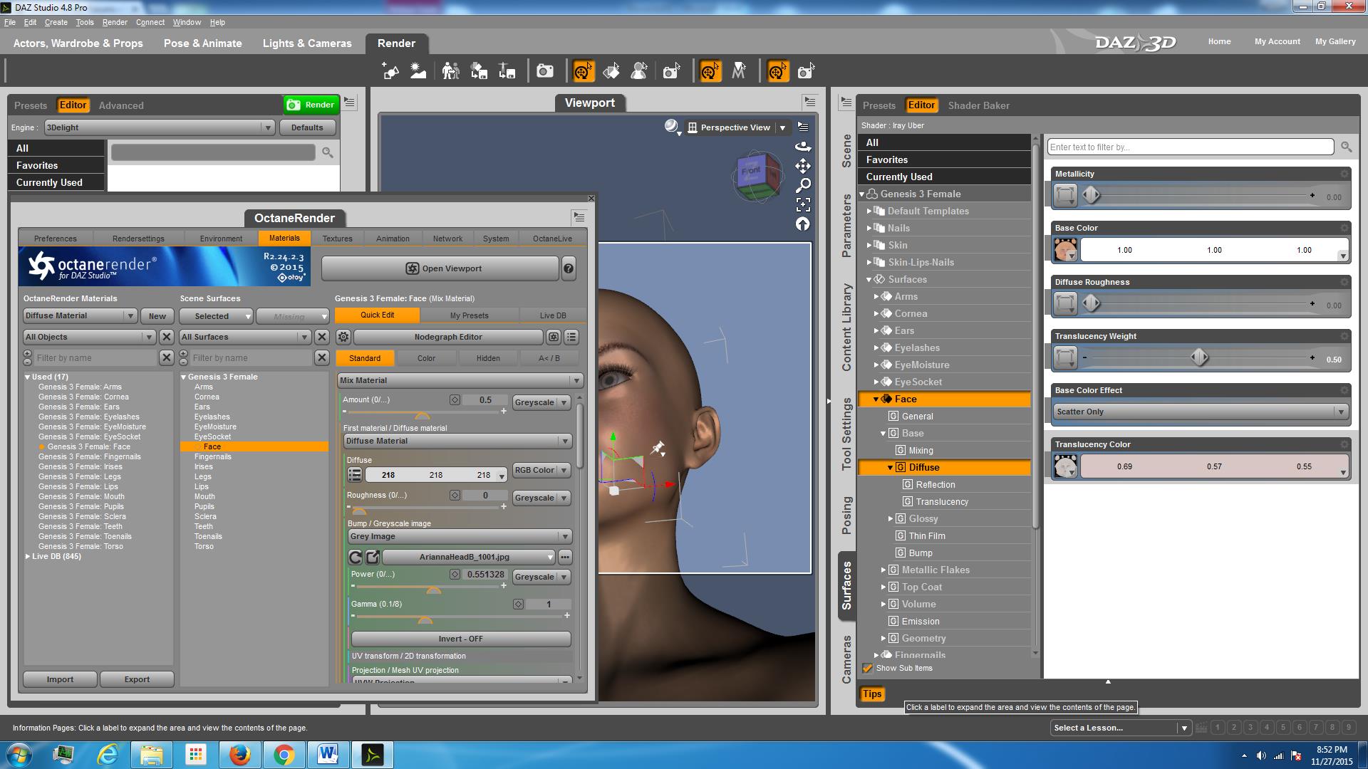

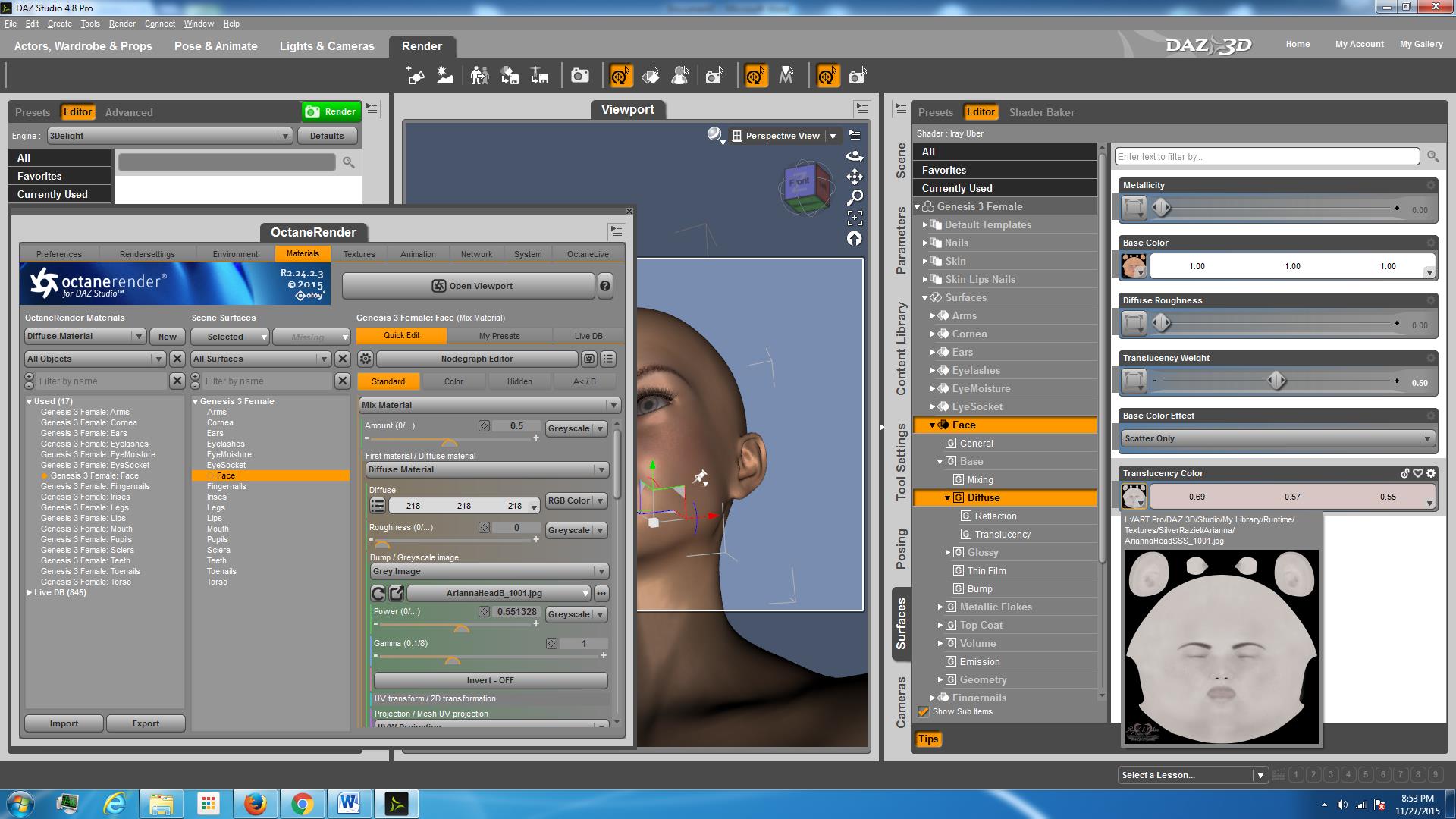

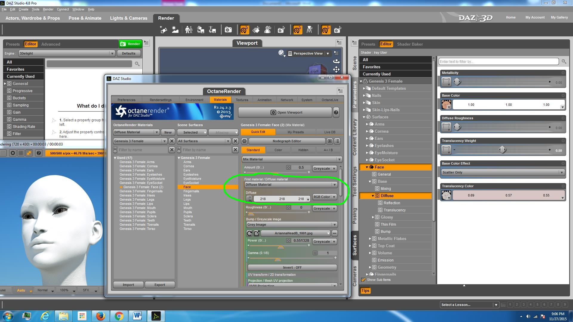

LOL :D

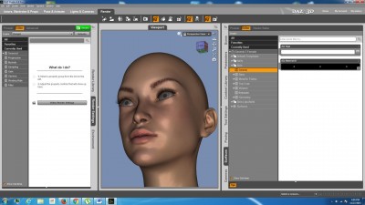

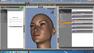

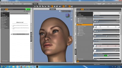

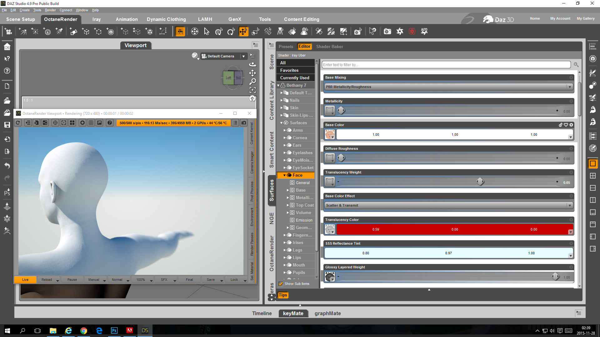

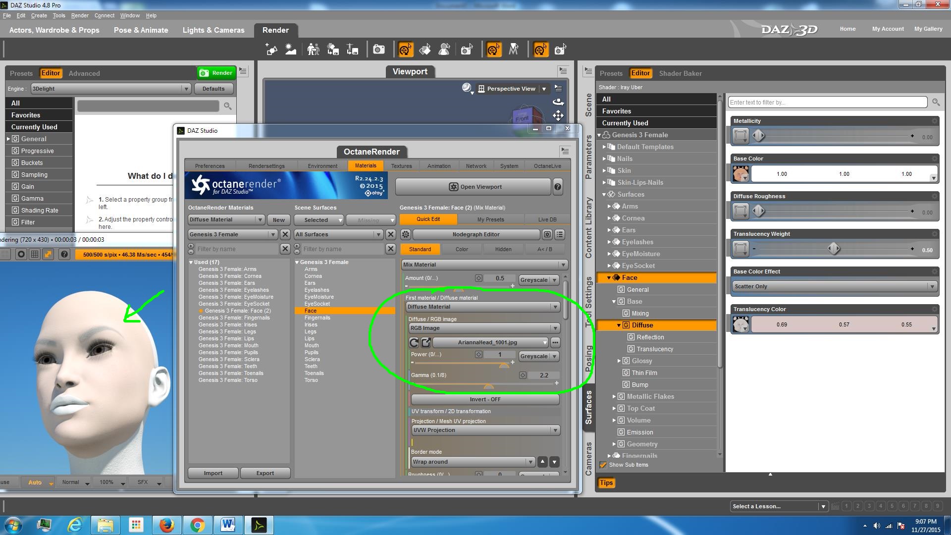

Here are the 2 instances of a map in Diffuse for the Arianna face material...The Base Color map does not go over to OcDS, if it did it would render properly.
Diffuse Selection
Diffuse Selection
Base Color Map
Base Color Map
Translucency Color Map
Let me know if we need anything else, thanks!

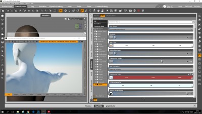

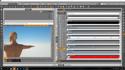

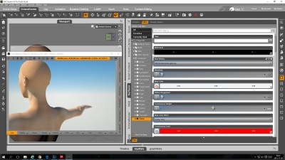

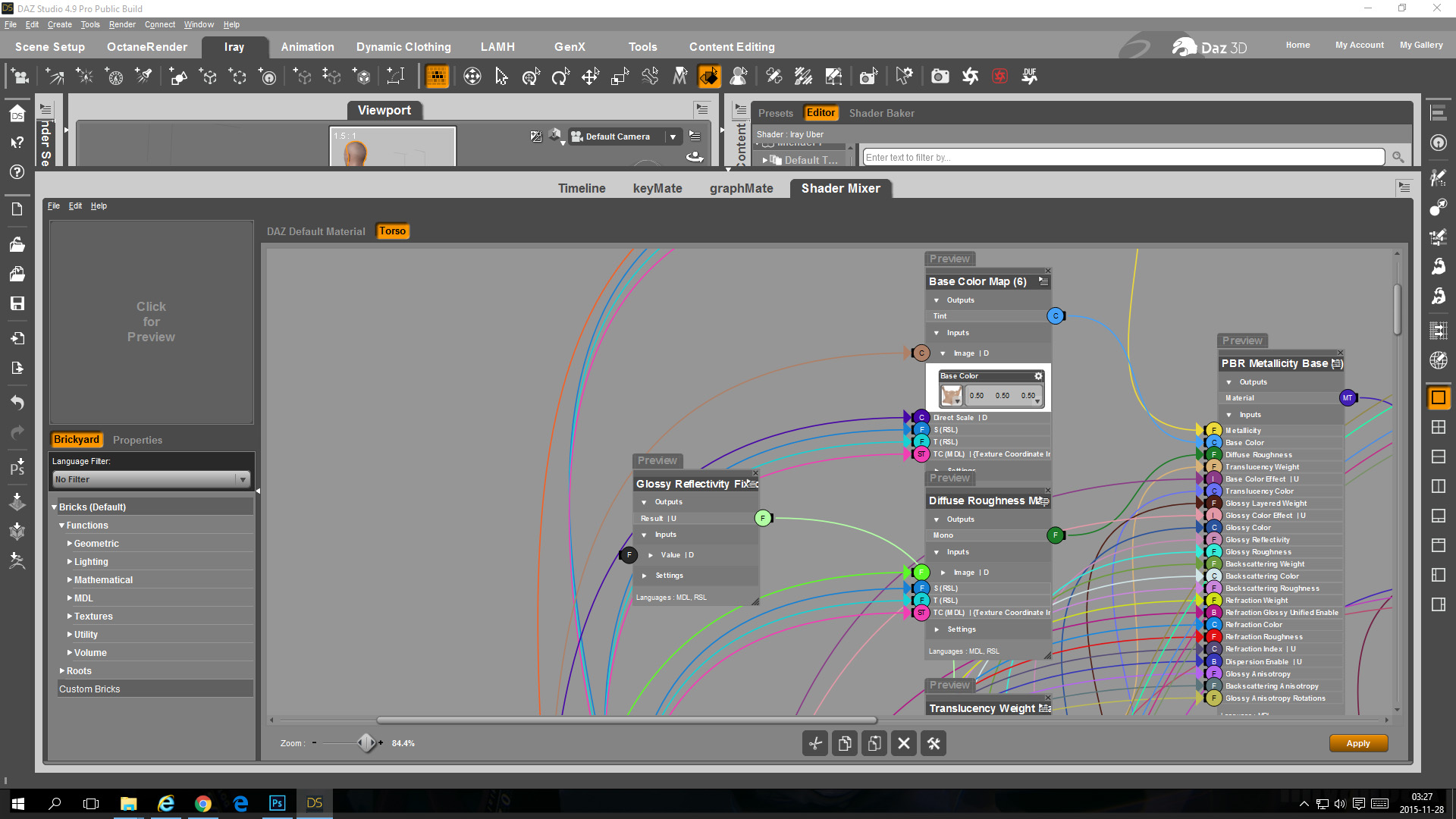

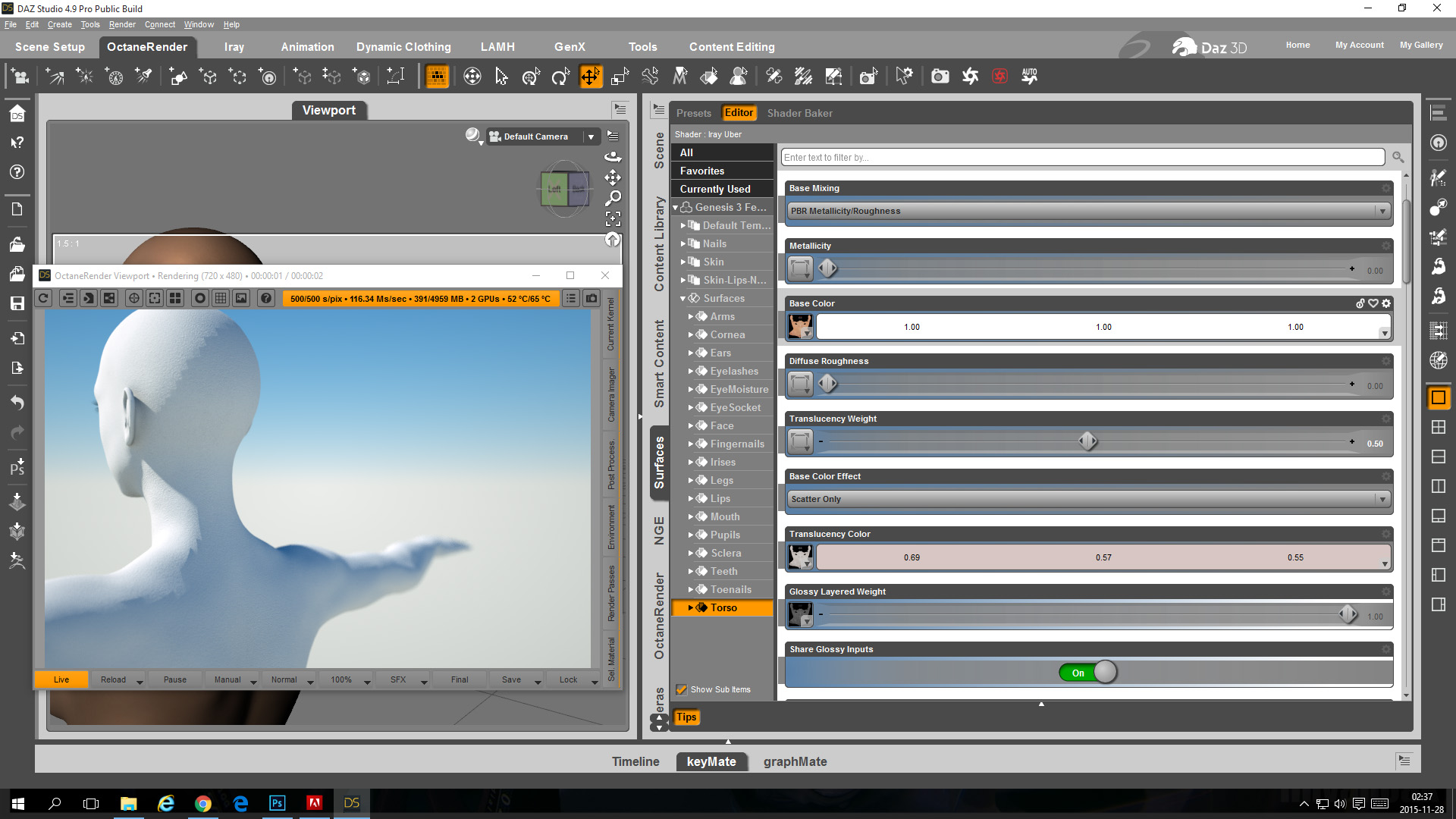

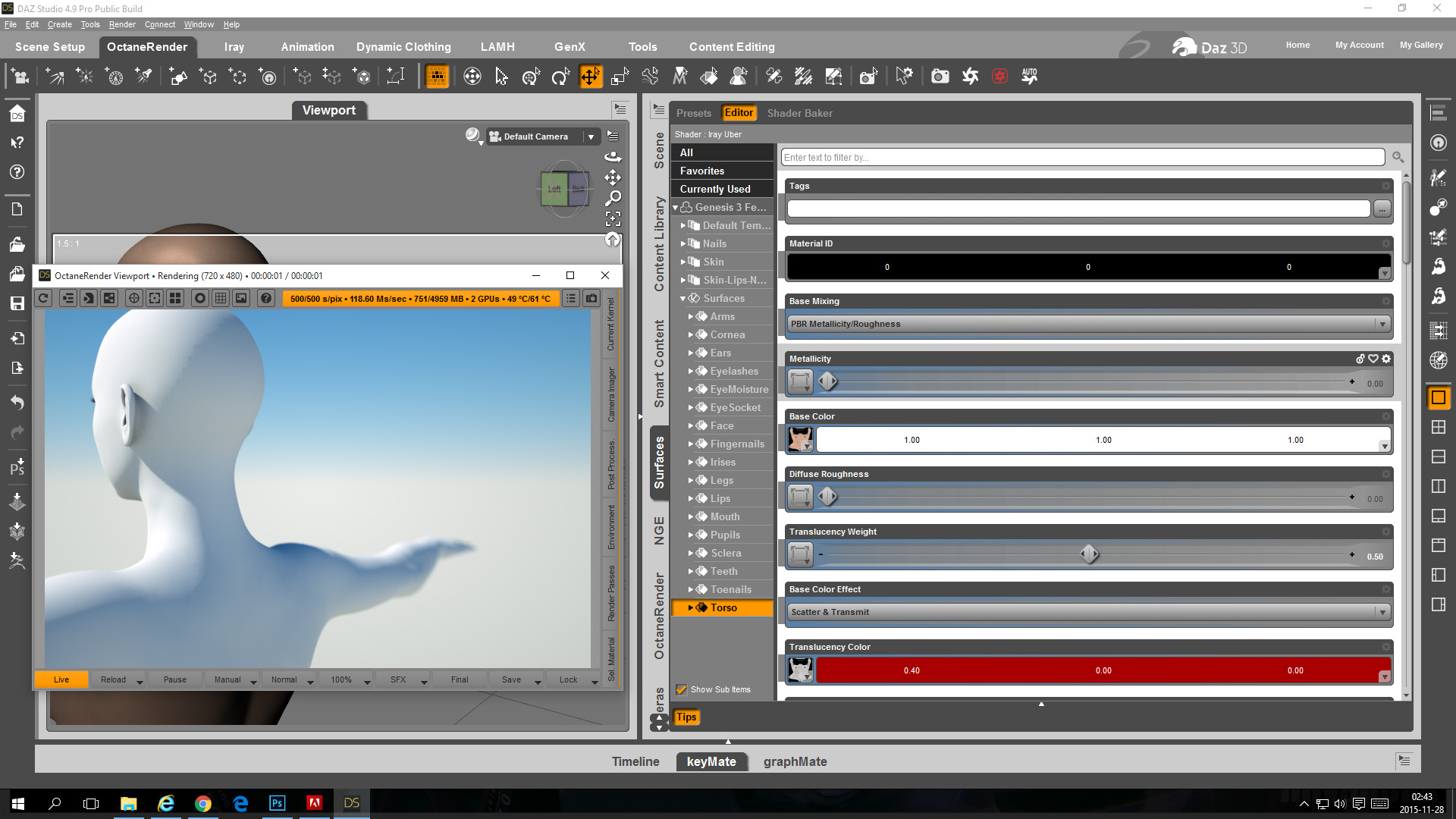

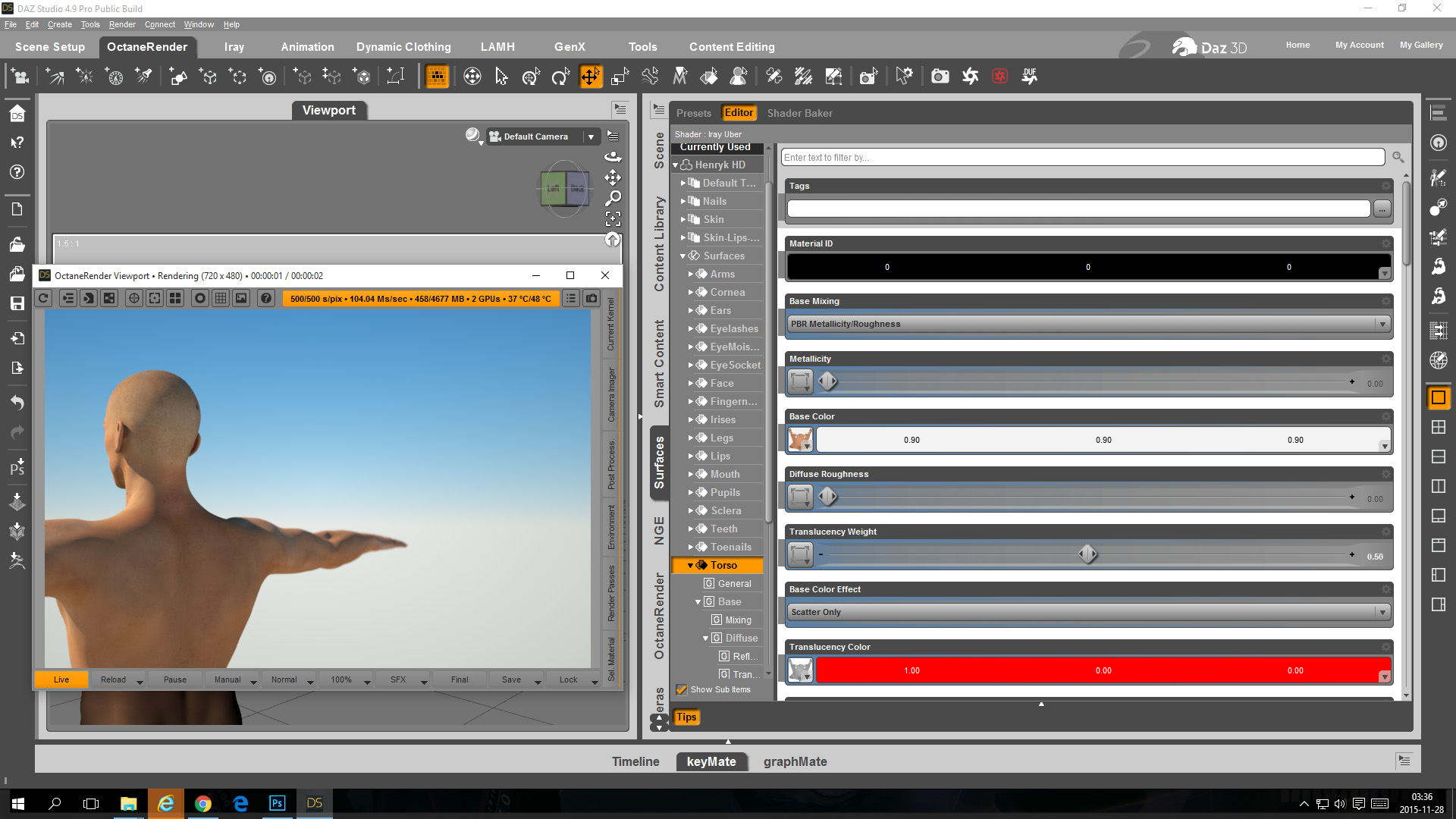

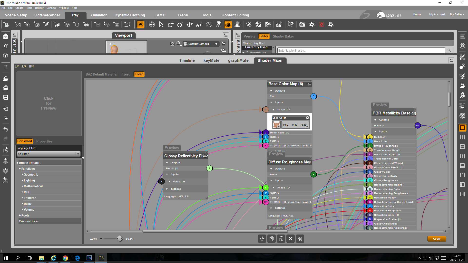

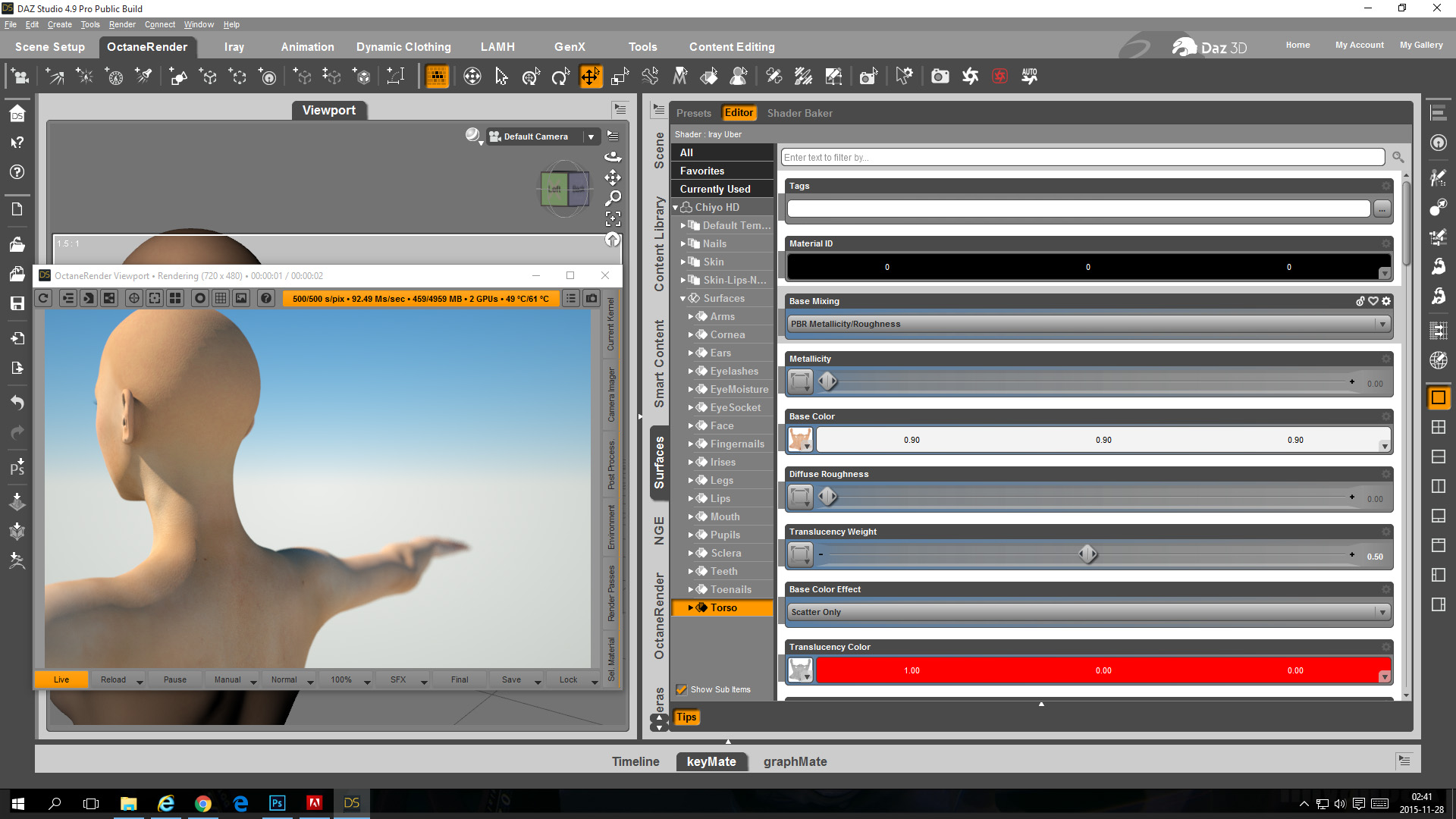

Update / Edit: added shader mixer comparison of Base Color Map.
Did also another test series with OctaneRender_for_DazStudio_2_24_2_3.
- Yesterday Victoria 6 was converted to white diffuse without map. Today a diffuse map was added.
I cannot yet see a logic behind it.
At first I thought it might be the Base Color Effect because Chiyo is working with it set to Scatter and all the others who are not working have it at Scatter & Transmit. But toggling to Scatter does not make the others work. And now I also found one who converts to white with Base Color Effects: Scatter.
It seems most characters who work have Base Color at 0.90 0.90 0.90 but changing it from 1 to 0.9 does not make the others convert properly either.
http://www.daz3d.com/henryk-for-michael-7
is converting with the diffuse maps.

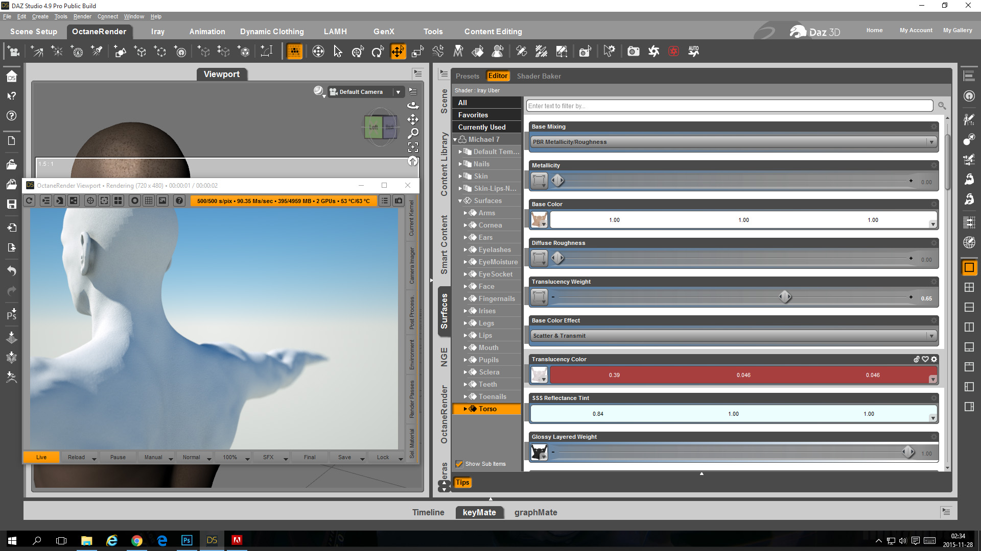

http://www.daz3d.com/michael-7
has the diffuse maps missing when converting.
Shader Mixer Michael 7
Just by looking at the Base Color Node in the Shader mixer I was not (yet) able to tell which difference is causing the map not to load in OcDS.
Maybe developers at DAZ3D can be of assistance by comparing on mass scale the node layouts and values of those material setups who do work with those material setups who do not work?
Maybe there is a script available who makes it possible to compare node layouts for similar and different values?

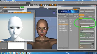

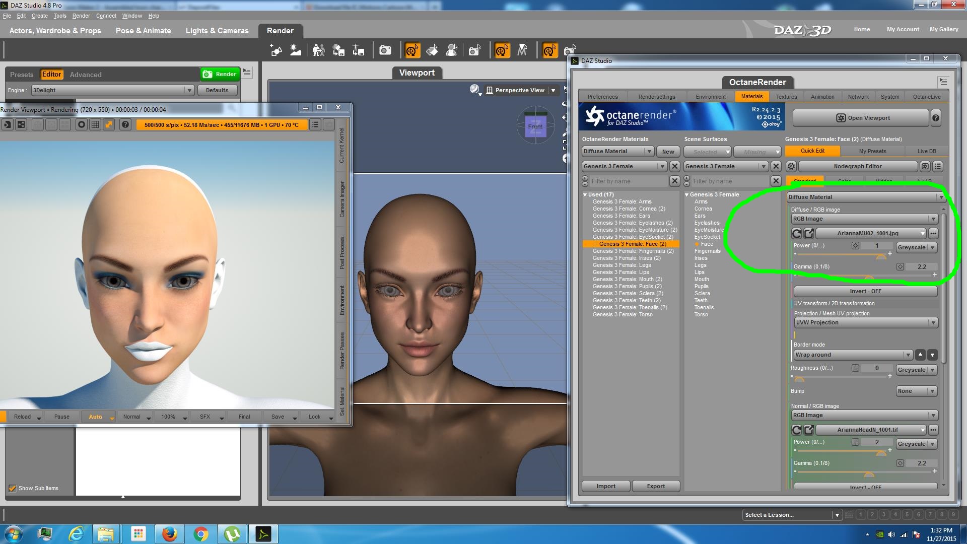

And Paul, look at this, it (G3F Arianna's face material) comes over in OcDS under the Mixed Material header, with 2 instances of a Diffuse Material..this is how you fix it, keeping it as a Mixed Material
Instance #1
Instance #2
So to fix in OcDS, keeping the Mixed Material header, you have to load the image in both Diffuse Mat instances:
Here is me changing 'RGB Color' to 'RGB Image' and loading image into just the 1st instance...yields a 50% rendered face map
Here is me then also changing 'RGB Color' to 'RGB Image' and loading image into the 2nd instance too...properly rendered face map
Now, if you change the master header from a Mixed Material to a single Diffuse ("Diffuse" in the drop-down), it gives you only one Diffuse instance, so you only had to load it once.
Master Header to a single Diffuse, only need to change 'RGB Color' to 'RGB Image' and load image in the one instance
So a fix could work either way, depending on if you keep it as a mixed material, or switch it to a single diffuse.
