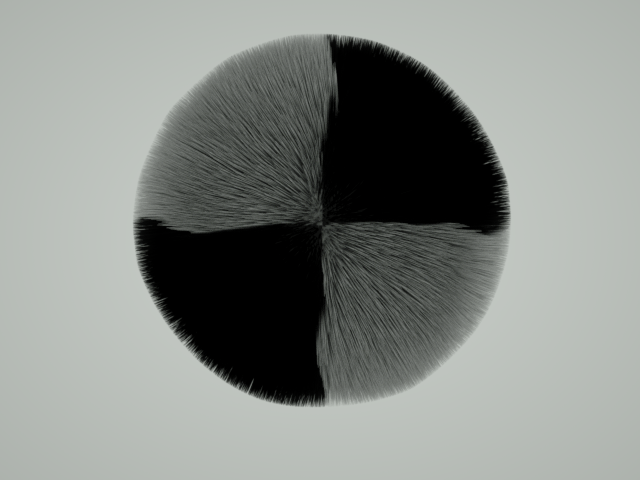

Here is a very simple example of uv mapped hair. I used the same octane shader for the sphere and the hair.
Make use you enable UV mapped hair...

Hi Sighman, Thanks for the test scene, well it certainly works for that, doesn't it! I tried substituting an image map and that worked on that set up too. Now if I could duplicate that for an actual hair model, we'll be away! No luck so far though.
