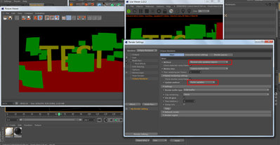

I think you missed somethings about settings. If you don't know that plugin how works, please use render settings as in image. It guarantees to produce same output on picture viewer and Live viewer. And please watch last tutorials in a free time about "render settings and optimisations".insertcoin wrote:i've seen that in 2.16.2 there is no voice under render setting for separate id layer mask.
So after watching tutorial found here : http://inlifethrill.com/trainings/octan ... ayer-mask/
i tried 2.22.2 test3 where menu render pass layer is present.
And yes, i've seen all possible tutorial.
I'm trying for two hours now.. but i can't see how to... and we are close to deadline..
thanks
That's reason why i have pinned this values as default.
