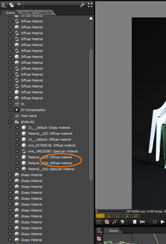

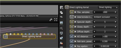

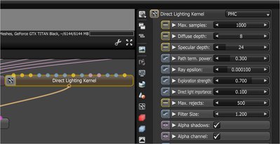

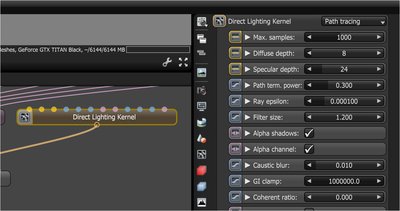

I have encountered a boring problem, as I change the kernel, the node graph change but not the name.
As you can se in the attached images...the name of node isn't updated.

I think the problem was in the plugin for C4D because I have noticed this problem occur only when the scene was exported in Standalone with the command "Edit in Standalone"
Indeed in the plugin I have encountered a similar behaviour, if I select the kernel on LV then in the setting it isn't update immediately, I need some click on both before they match.

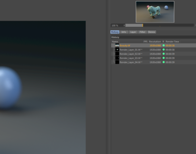

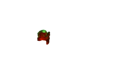

Nevertheless, I have a question about certain behaviour.See the image attached.
The first file rendered is a flat beauty image. Then that very same composition is broken down to layers by using the render layer system.
Can anyone come with an explanation why do the render layers, which have just a few pixel of data in them, take the same time to render as the full on flat image? I realize there is some solid math behind all this but I really wish there is a way to optimize the render time when using render layers so that it matches the amount of pixels actually being rendered. Otherwise this is pain..

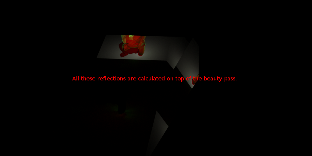

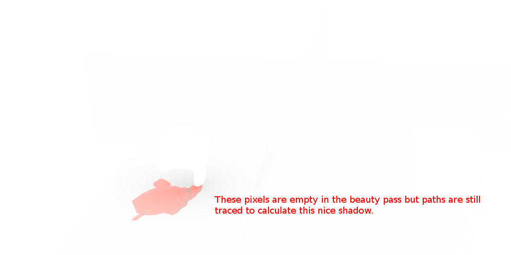

I will try to explain. Even though you might see an almost empty scene. For all those empty pixels, paths are still traced to calculate the shadows and reflections from the object(s) in the active layer. We calculate exactly the same scene but we split the result over several render results:
Beauty pass
Beauty pass
Shadows are calculated even though not visible in the beauty pass.
Reflections are calculated as well even though not visible in the beauty pass.
The idea is that you have your objects properly cut-out (without all the headaches caused by masking out) together with the shadows and reflections. That way you can immediately take all your results and compose them onto something else.

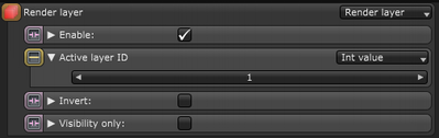

That's why it roughly takes the same time. If you only need the isolated objects, you can use the "Visibility only" on the render layer node. This won't calculate shadows and reflections and speeds up things. Note that the speed increase will always be slightly less than if the object wasn't there in the first place (because the camera ray still needs to be traced to see if we hit an object).
The visibility only option as seen in the Standalone.
I hope this makes things a bit clearer?
