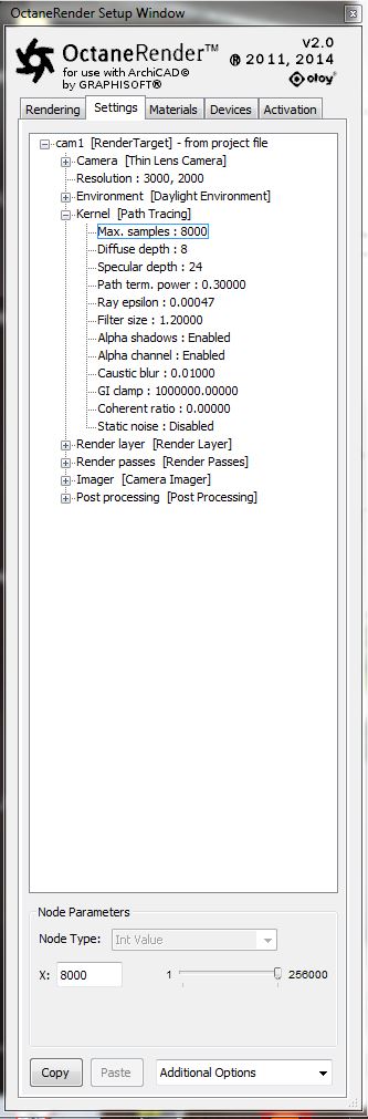

Hi Paul,
I noticed in 2.22 the max samples slider does not go over 8000.
Typing does work to get higher number.

I have refreshed the installers at the top of this thread with:
2.22.2.42
- Fixed issue where the render would not save to a folder with special characters in it
- Fixed issue where the Max Samples slider would not go higher than 8000

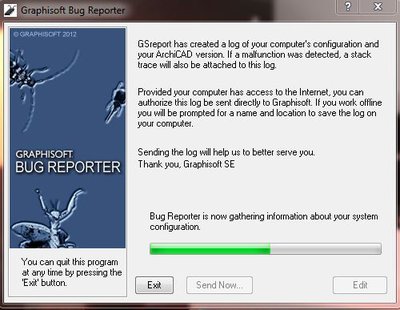

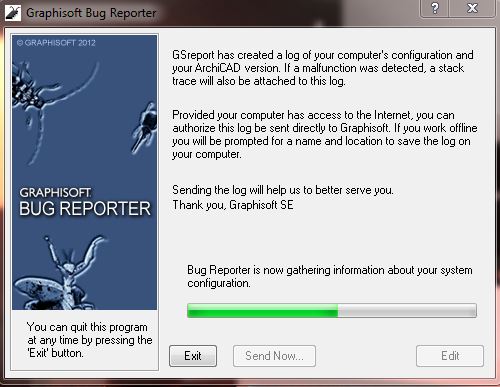

Hi Paul,
Got a quick quit error when opening the render viewport.
greetz,
edited: trying second time it happens again
BugReporting-18-150428-1.zip
(60.61 KiB) Downloaded 281 times

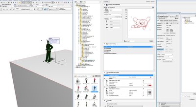

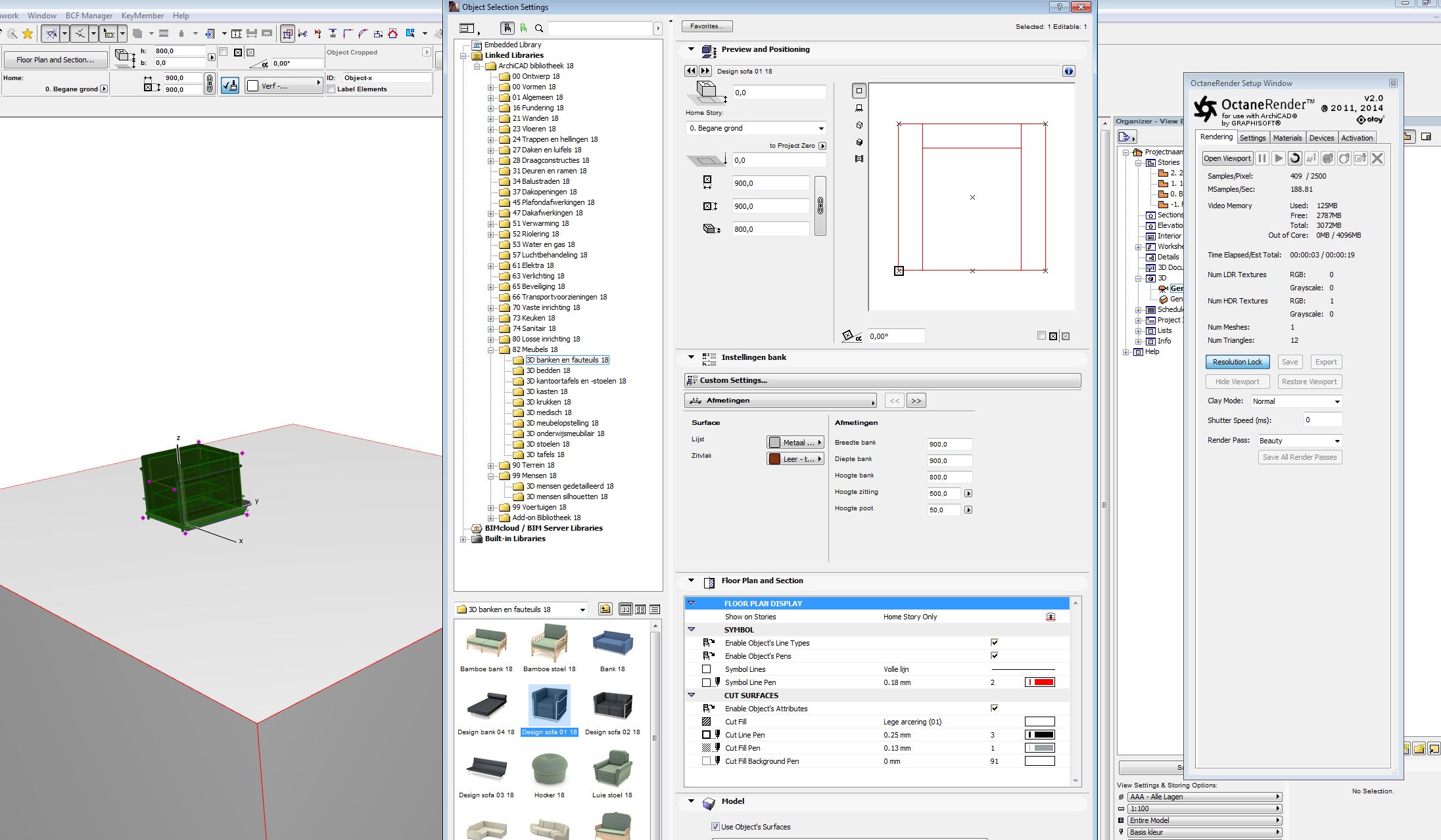

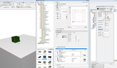

rappet
Posts: 1962
Joined: Fri Apr 06, 2012 3:57 pm
Location: The Netherlands
Hi Paul,
New clean scene and added floor slab with materuial (without texturing) and the viewport opened without problem.
Will check if the problem is the texture or the people object.
greetz,
edited: it is the people object that gives the error!
edited 2: also another object gives the error.
4090+3089ti & Quad 1080ti
