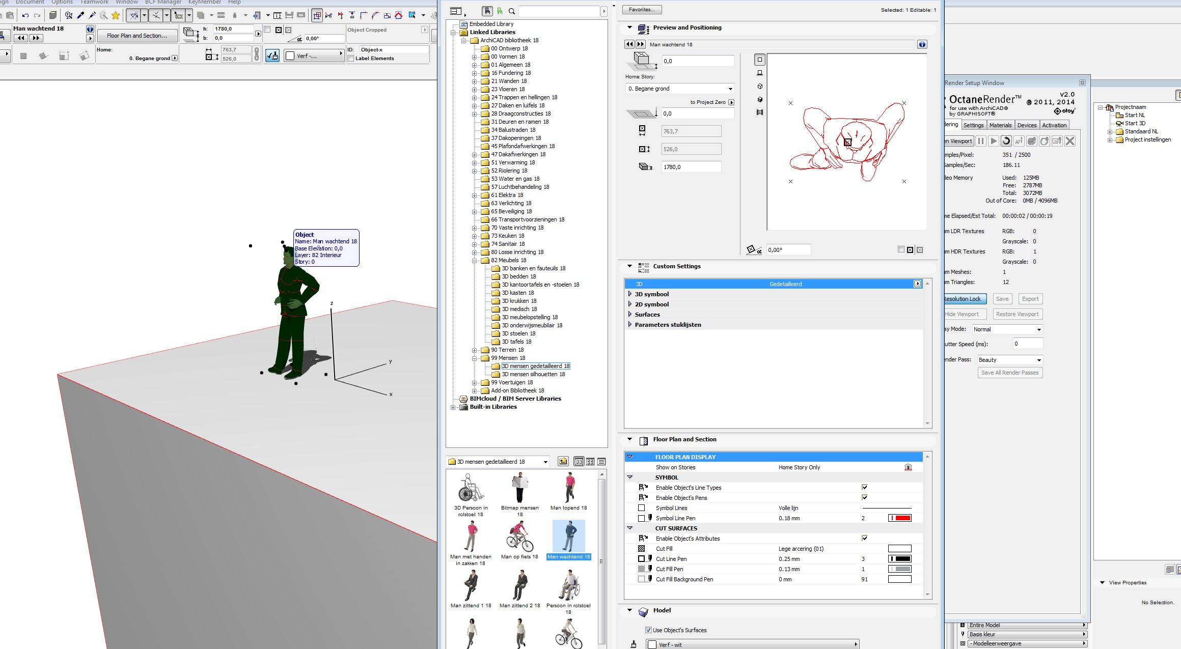

Hi Paul,face_off wrote:Following is an experimental build - seeking feedback from willing testers.
2.22.2.44....
Paul
Got a quick quit error when opening the render viewport.
greetz,
edited: trying second time it happens again

Thanks Jeroen - is it happening on every scene, or just one? Does the scene have proxies? Were there any texturemaps reported missing when you opened the plugin?
Paul
Paul
Hi Paul,face_off wrote:Thanks Jeroen - is it happening on every scene, or just one? Does the scene have proxies? Were there any texturemaps reported missing when you opened the plugin?
Paul
It was a clean scene.. Just started for this test.
I had only added a floor slab and an ArchiCad standard 3d people object .... without any proxies yet assigned.
No other reports like tetxures missing.
I will try a new scene with even less to start the render viewport.

Hi Paul,
New clean scene and added floor slab with materuial (without texturing) and the viewport opened without problem.
Will check if the problem is the texture or the people object.
greetz,
edited: it is the people object that gives the error!
edited 2: also another object gives the error.
greetz,
