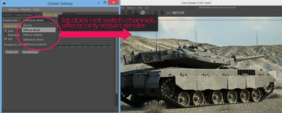

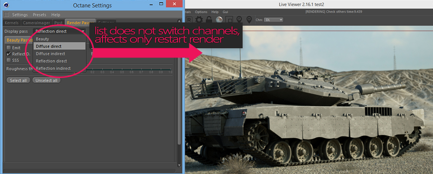

sorry if already posted, but in Rednder tab Display pass doesnt change passes.. only if resend&restart render

arsen wrote:sorry if already posted, but in Rednder tab Display pass doesnt change passes.. only if resend&restart render
what do you mean exactly?
arsen
Posts: 15
Joined: Tue Sep 27, 2011 6:59 pm
it works in 2.12
Posts: 16068
Location: Türkiye
arsen wrote:
it works in 2.12
fixed
