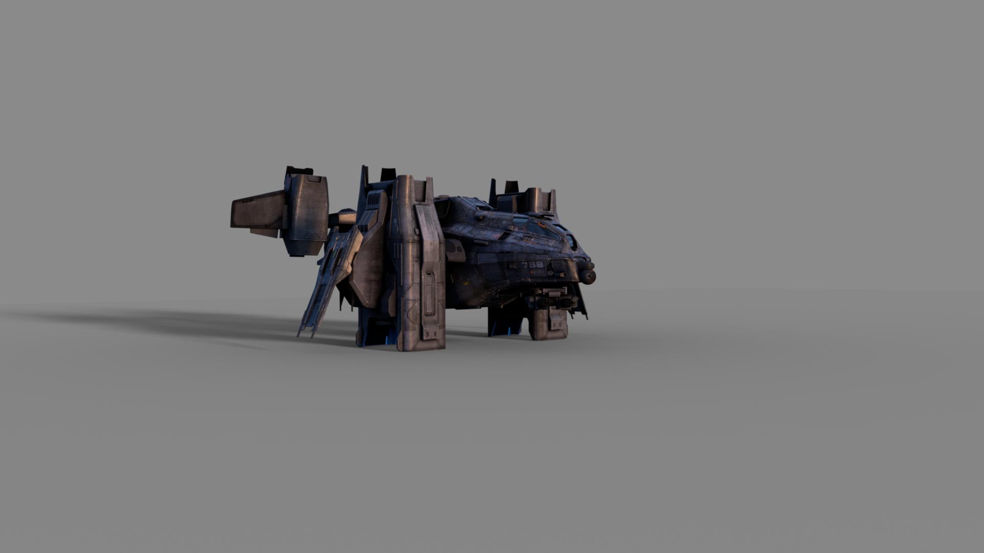

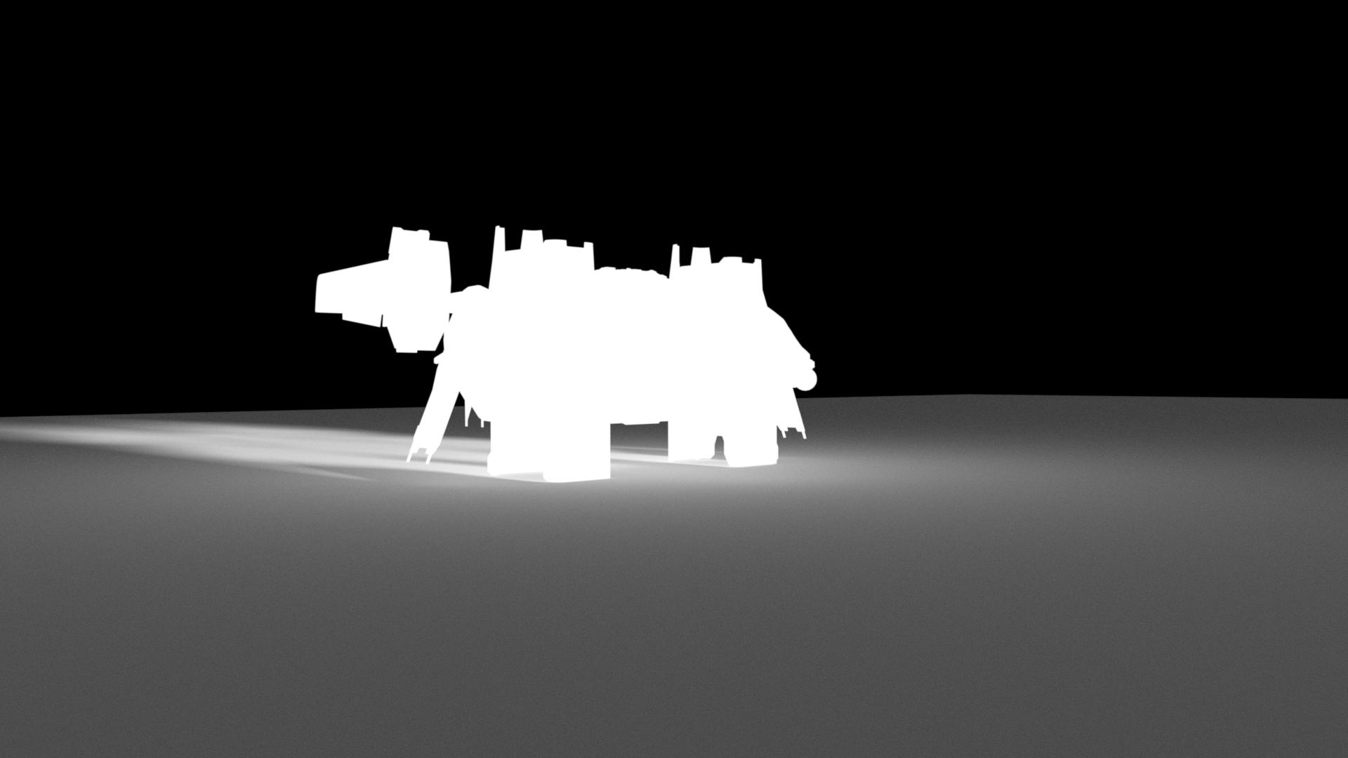

I have seen many posts about the Matte Objects and how they are not Ideal. I am rendering a ship that I need to composite into a live action shot. I try to render the ship with a ground plane that has a Diffuse Material and the Matte button selected. Nothing else is in the scene to account for the shadowing that is hitting the ground plane. Am I doing something wrong? If so, can I get some guidance?

do you checked "alphacannel" ?

Yes.
For eliminating the overall unwanted shadow on the ground plane.
You'll need to test if turning off Importance sampling work.
Besure to set the kernel to ambient shadow.
But I guess that functionality no more working in the recent 2.15. Maybe I'm wrong but maybe it's a bug.
To be sure test this with v2.13
Hope it helps.
