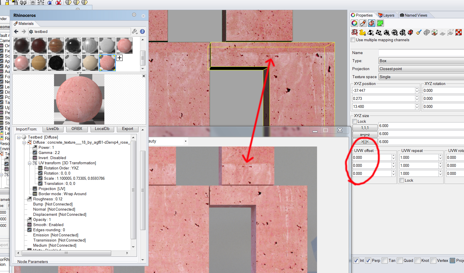

Hi Paul,
Is there any chance to make the rendered display mode on the viewport match the exact placement of textures in octane?
Just checked for scale it is ok, but no matter what, i always get offsets for placement..
How are you scaling and placing the textures in Octane? Can you pls post some screenshots of the Octane material with a scale and then a placement (showing the node layout) and the corresponding Rhino preview image?

waterthinking
Posts: 67
Joined: Fri May 28, 2010 8:27 am
here you go..
the scale looks good to me, it is just that the position of the texture doesn't match
