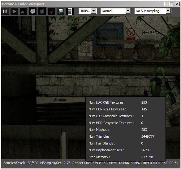

It looks like it works
Number of HDR textures looks wrong in that screenshot. I will check that out.
