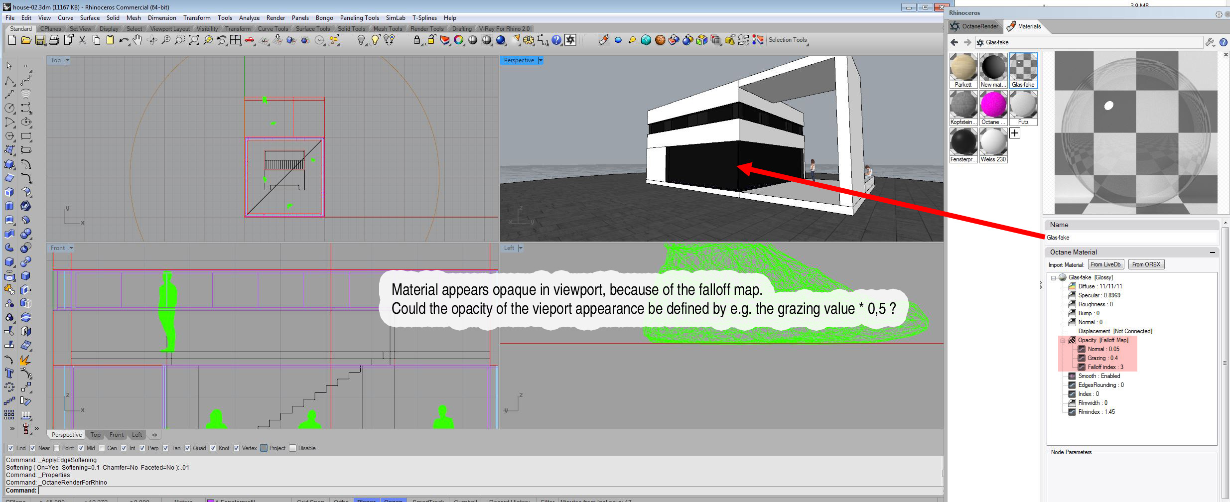

Hello Paul,
A small thing...
since I almost always need an alpha channel for my glass, I now use a "fake" glass material, which uses a falloff map in its opacity channel.
An unwanted side effect is, that the fake glass material is 100% opaque in the viewport.
Is there a possibility to derive the viewport material opacity e.g. from the grazing opacity value multiplied by 0,5? this way it would be possible to have a subtle representation of transparency for the viewport.

face_off
Posts: 15812
Location: Adelaide, Australia
Hi Andreas - I will include this in the next release.
