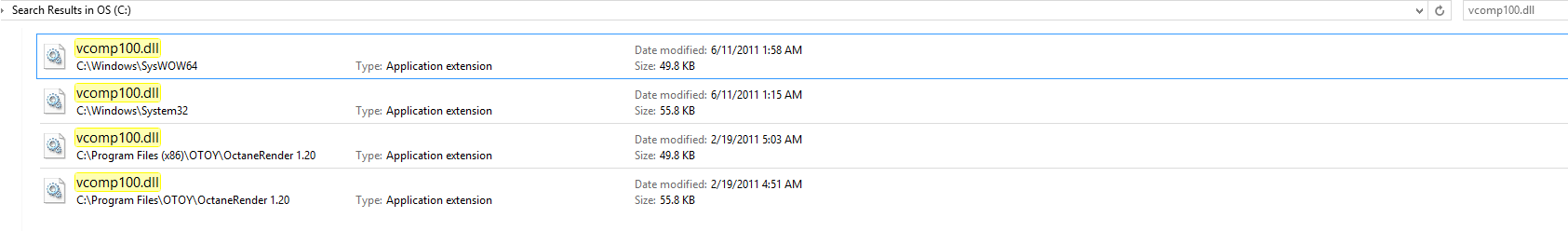

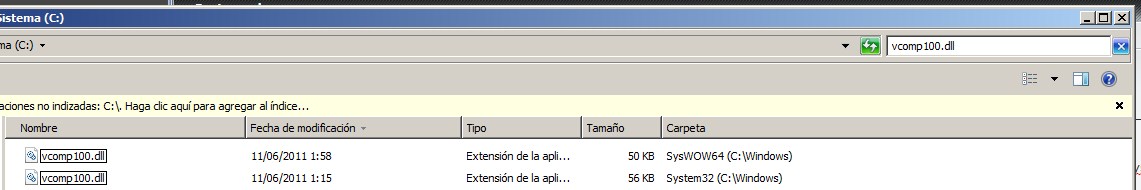

Perhaps like you say before we have a problem with the redistributable. It installs in your system the "vcomp100.dll" file.
You can try to search this file in your HD to see how many copies of this file are installed, perhaps a driver or other system component installed a wrong version of this file ...
-Juanjo
-Juanjo

I think that your vcomp100.dll files are OK. Plugin uses the system vcomp100, while Octane Standalone uses it's own dll.
