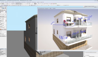

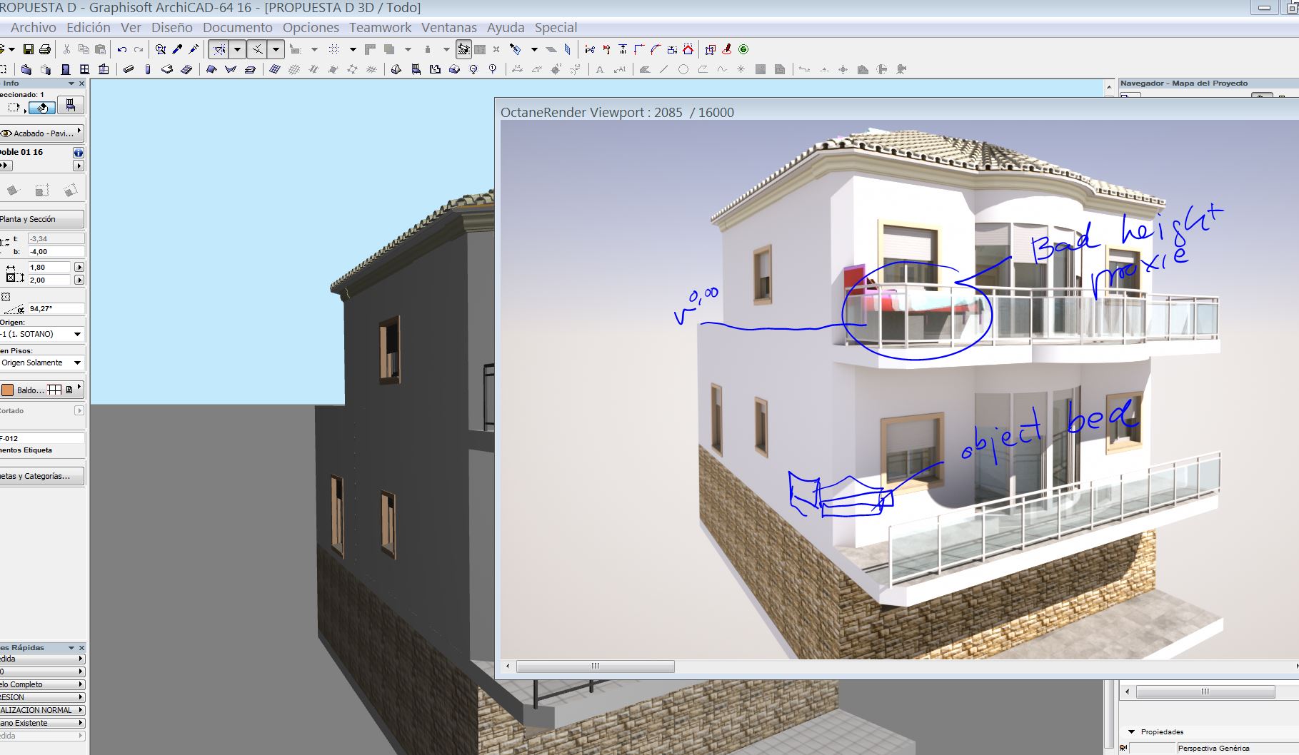

I have some issues with the proxies heights. As you can see in the pics the bed its a proxi in the level -1, but the proxi appears in octane with the right x-y but with the z at 0. Is there any form to change the coordinates of the proxie? maybe with a csv?

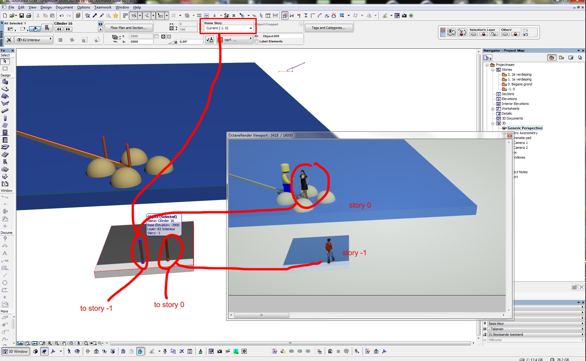

I tried to find out why the proxy is not on the right level.
when the AC object is on another story and set to that other story the proxy is located on the groundfloor and not on the current floor.
This also happens on higher level story.
When the objects "home story" is set to the story 0 (groundfloor) it locates the proxy on the right position relativaly.
@Paul, does that makes sense to you to fix/change?

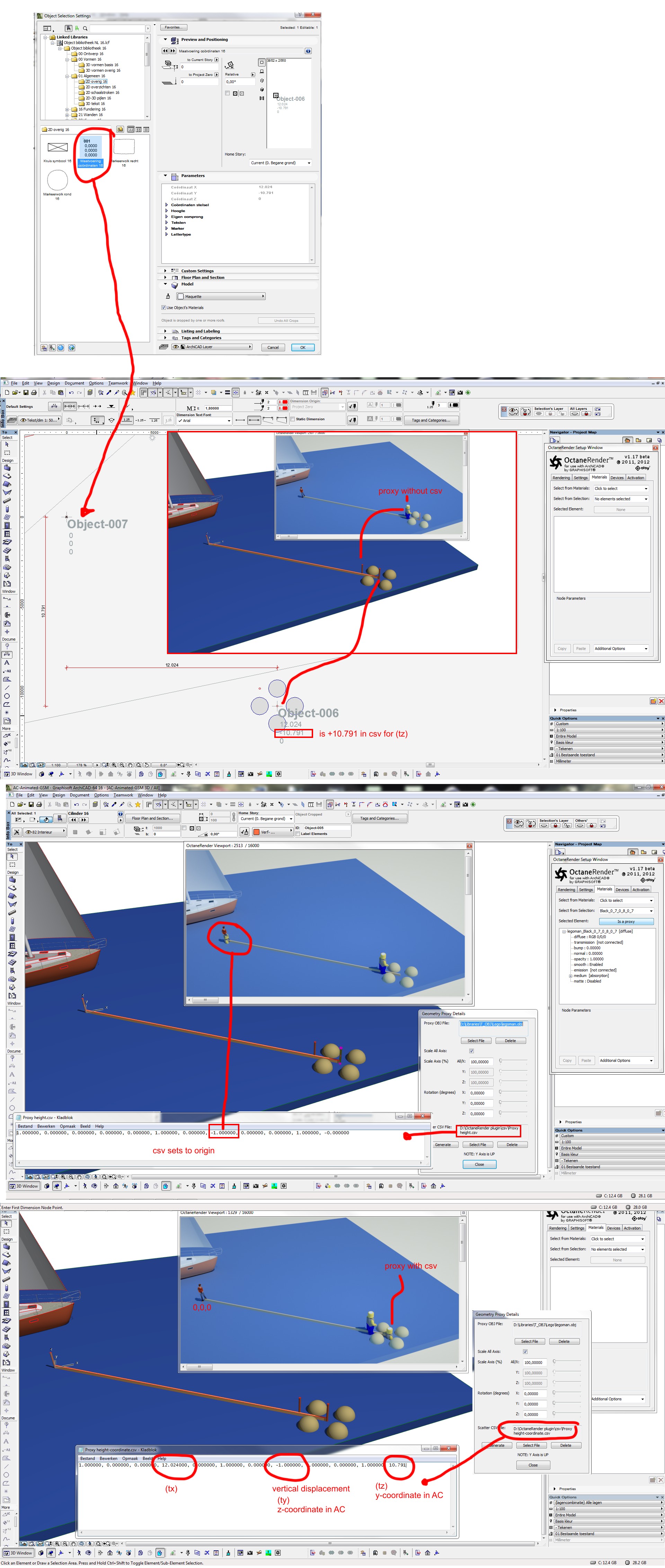

Hi, this issue will probably be fixed by Paul if possible.
A workaround with csv is quiet a hazzle, but maybe this example is handy in future for other issues?
Therefor I added an image where you can see how to locate a AC object and how to transfer to a csv.
greetz,
I will fix this.
