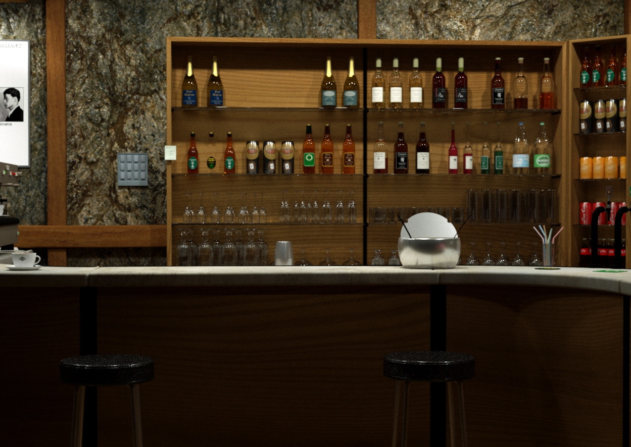

I was copy/pasting a lot nodes: Copy a node, right click, copy, move cursor to next node to change, select it, right click, paste. I had to do that about 200 times with 4 different type of nodes. I made about 10 mistakes (while watching it) because of the bug. Often you just move the mouse to quickly to where the paste menu item is going to be and it ends up being pasted on the node below. You only notice when you render that something is odd
In the attached test render you can see that there are many nodes. Most of the bottles have different materials for glass, label, contents and cap. So there are many nodes here
Configuration: Windows 11 Pro, I9 12900K, 128GB, RTX 3090, P12 b1029
