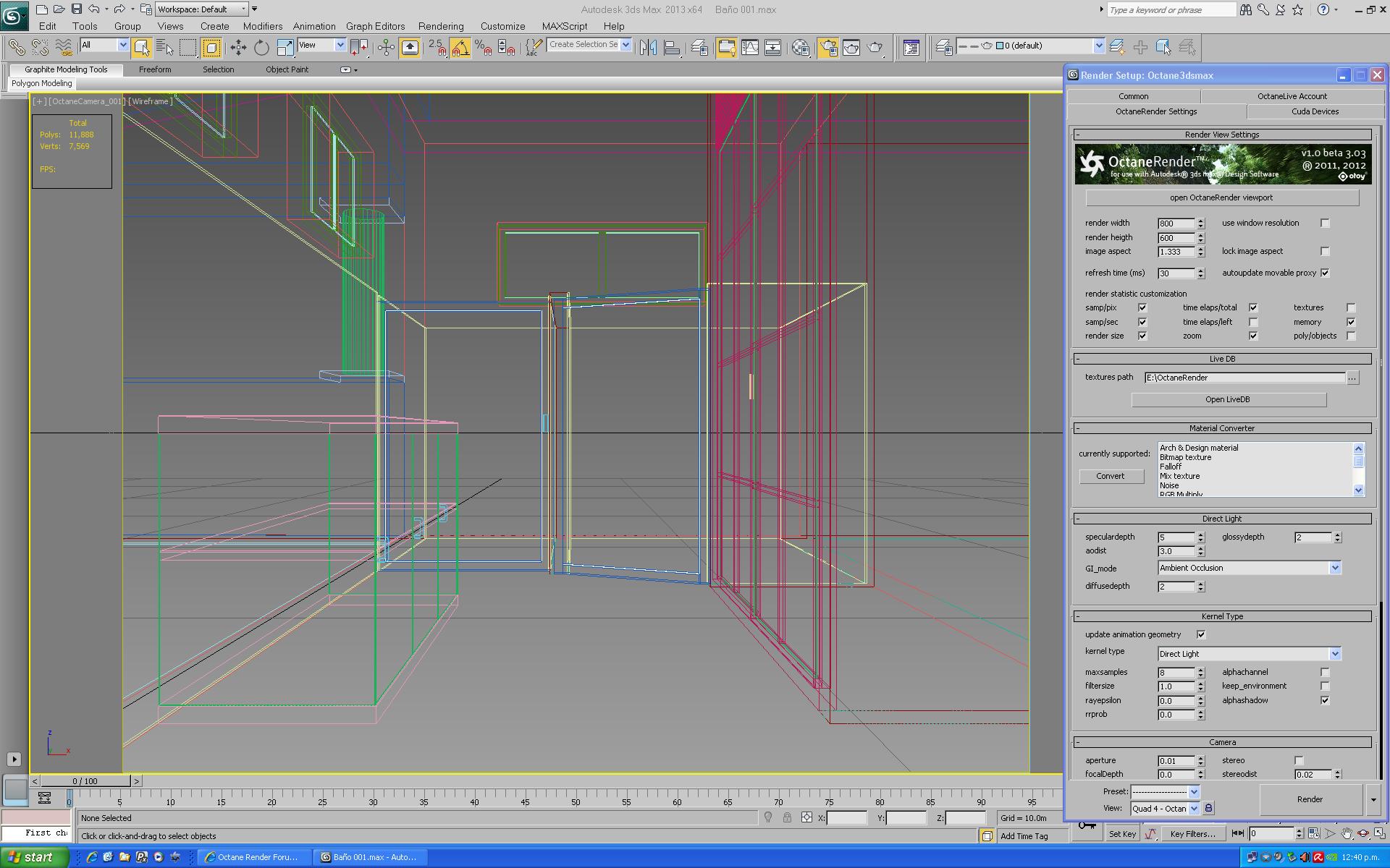

hi karba i have a problem, when i try to put modifier uvm mapping the 3dsmax 2013 close it without warning, this happen if i have open the octanerender viewport, if i close this view dosen't happen nothing
can you help me ? my scene only have a 11,888 polys, verts 7569
i add image of the space
thank you karba

merid888 wrote:hi karba i have a problem, when i try to put modifier uvm mapping the 3dsmax 2013 close it without warning, this happen if i have open the octanerender viewport, if i close this view dosen't happen nothing
thank you karba
Can I have your scene?
[email protected]
