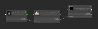

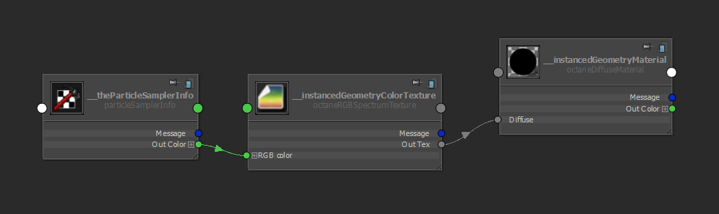

Instancing shading test scene:
http://goo.gl/SErjF
Made with 2.58p and Maya 2013x64. Click the annotation and read the nodes for details.
Below is the ideal setup for shading instanced particles.
[Edit: File updated with license for Otoy to use for testing.]
Ideal instancer shading network.

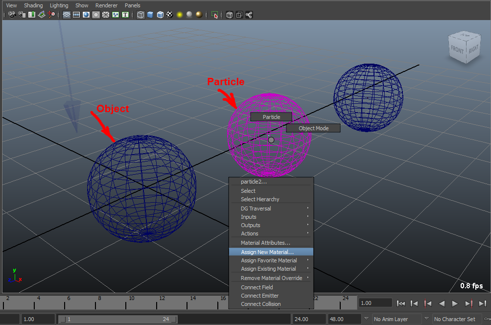

But I see that I can set the shader to the particle itself in Maya, not only to the object... Maya does not have the standard API means to get the material of the particle when iterating particles and particle's instances, but it can be done during the attributes connections... And in this case I can bind own Octane material to each particle...
Is that what you mean?..

JimStar wrote:But I see that I can set the shader to the particle itself in Maya, not only to the object... Maya does not have the standard API means to get the material of the particle when iterating particles and particle's instances, but it can be done during the attributes connections... And in this case I can bind own Octane material to each particle...Is that what you mean?..
Yes, as I understand it in Maya you can set per particle RGB values and shaders but the particle instancer node gives us no access to the indivudual instances at the shader level, though as I'm not hugely experienced with particles in Maya there could be a way I'm unfamiliar with. The way I've delt with it in the past is to have more than one base object, one each for every shader variation I need, and then use the instancer multi object controls to distribute them. Not as efficient as you require more than one base object just for shader variation.
If you can find a way to give us control of shader distribution in a particle instancer node that would be awesome!
