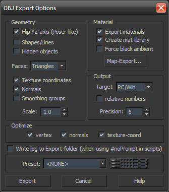

Hey Kubo,
Do you use a preset in the objexp dialog? If so maybe set it to no preset.
You can check the objexp setting by evaluating this in the maxscript listener:
shelllaunch(objExp.getIniName())""
(keypad enter to evaluate the line)
Heres an image of what my settings are, 2011 as well so it should work!

Hello
You were right! superb!, it was the damm default preset... go figure...so now I can finally play with animation... oh well... no sleep for me... it's so tought to have so much fun with octane... hehehe
