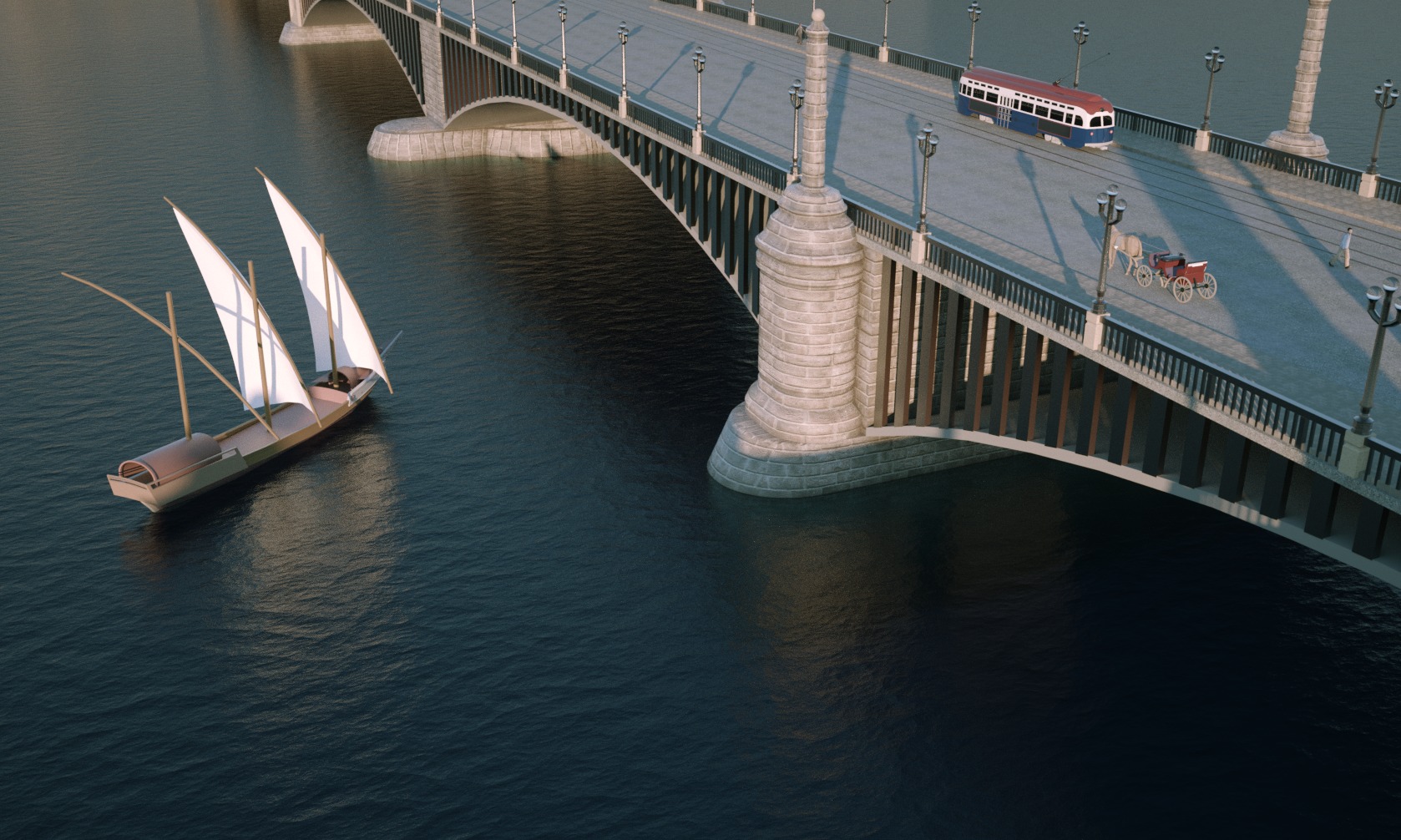

Rudi wrote:The water looks like a plastic foil.Why can octane render use not the water shader of C4D? He looks just real.
a test from me, how is looking?
LOL, you can do. what water shader that you`re talking about?
Create -> New Material -> Bump -> Texture -> Surfaces -> Water.
One cannot use this in octanes Render. Unfortunately.
If he is used, one receives a smooth surface.
Or is there a trick?
Turbulence from octanes Render simply looks not like water, but how a foil.:(
Comparisons both Shader sometimes
Then you see comparisons both sometimes, the difference. I help myself meanwhile with textures, but it would be really great if the Shader could be used by C4D.
Posts: 16068
Location: Türkiye
c4d native shaders works on different space. Octane cannot support because it's making cuda based calculation not cpu.
Plugin uses a baking method for these shaders and convert them to images. And apply. If you set enough big you can see better textures. But i think you need very big sizes for a sea, not possible to get nice resolutions for close views on big objects.
