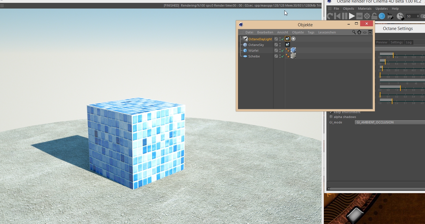

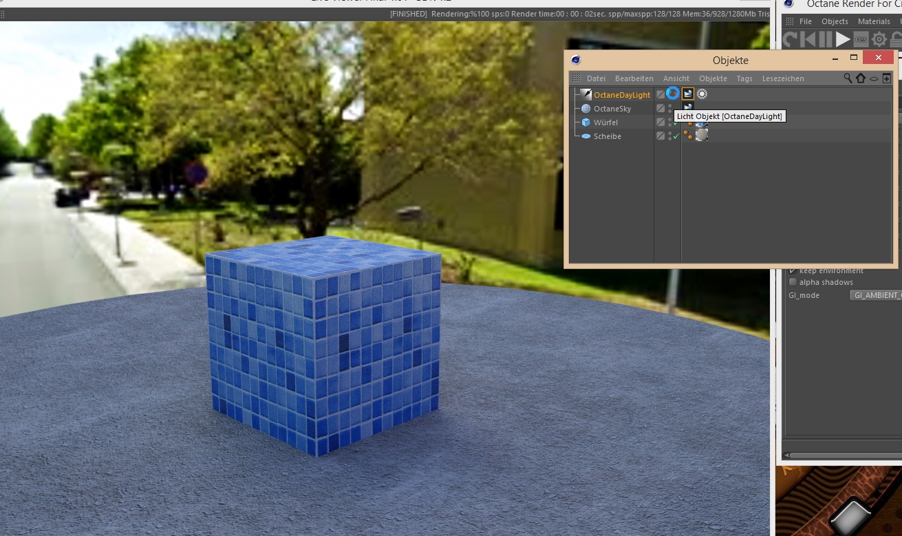

Question rgd. HDRI vs. daylight:
Why isn't it possible to render daylight and HDRI at the same time? As soon as I switch daylight on to get nice sun casted shadows the HDRI environment dissapears. But without the daylight no shadows are invisible.
Ron
HDRI environment invisible
Shadow invisible
Shadow invisible

Ron wrote:Question rgd. HDRI vs. daylight:
Ron
One environment obscures the other.
have you tried turning up the power on your HDRI?
Yes - I did. See example. Power was cranked up to 9. The HDRI nearly dissapears in the sky, but the shadows are soft and subtle instead of harsh and deep like in sunny conditions.
No_Shadows
No_Shadows
Master: WIN 10 64bit, i7 4930 4,5 Ghz, 64 GB RAM, 1600 W PSU, 1 TB SSD, 14 TB RAID, 2 x RTX 3090

Ron
Posts: 370
Joined: Sun Sep 25, 2011 7:11 pm
Aoktar,
any hints regarding my shadow/environment issue?
Even a workaround using a simple zylinder with a panorama image as a backdrop is not working out because the zylinder casts shadow into the scene even if I exclude it from the daylight source.
Thanks - Ron

Ron wrote:Aoktar,
Thanks - Ron
look to 1.10 for that

Ron wrote:Aoktar,
Thanks - Ron
You have the right idea of what to do. You can try using 1.10 and obscure the shadow from the cylinder.

Ron
Posts: 370
You really mean me to go back to version 1.10 to make this possible? Don't understand why this 'feature' was in 1.10 but is missing in 1.20.
In architectural visualisation this kind of setup is common. Isn't this an issue for other Octane users?
Ron
