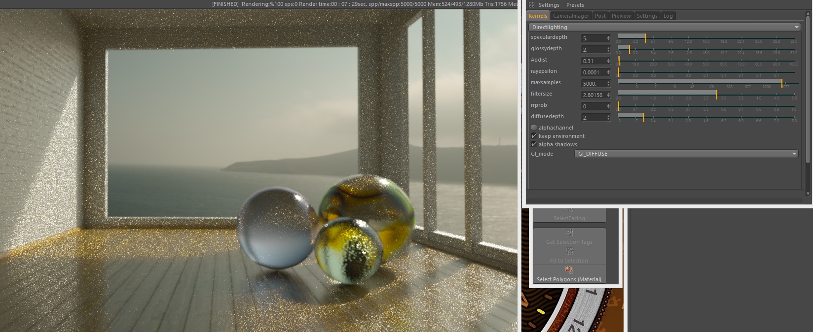

Hi Aoctar,
V 1.01 is working fine for me under Win8.1 with R15. Thank you for all the effort you put in to develop this plugin. I appreciate it very much.
Two issues came up doing renders with V 1.01:
1) Saving images is not possible using the 'FILE/SAVE AS! dialog. No image is saved.
2) Rendered images using HDR environment force a lot of noise. I tried with many different methods but no clean result. Attached is an example image. Please have a look and let me know what is wrong.
Thanks and best regards
Ron
Ron
