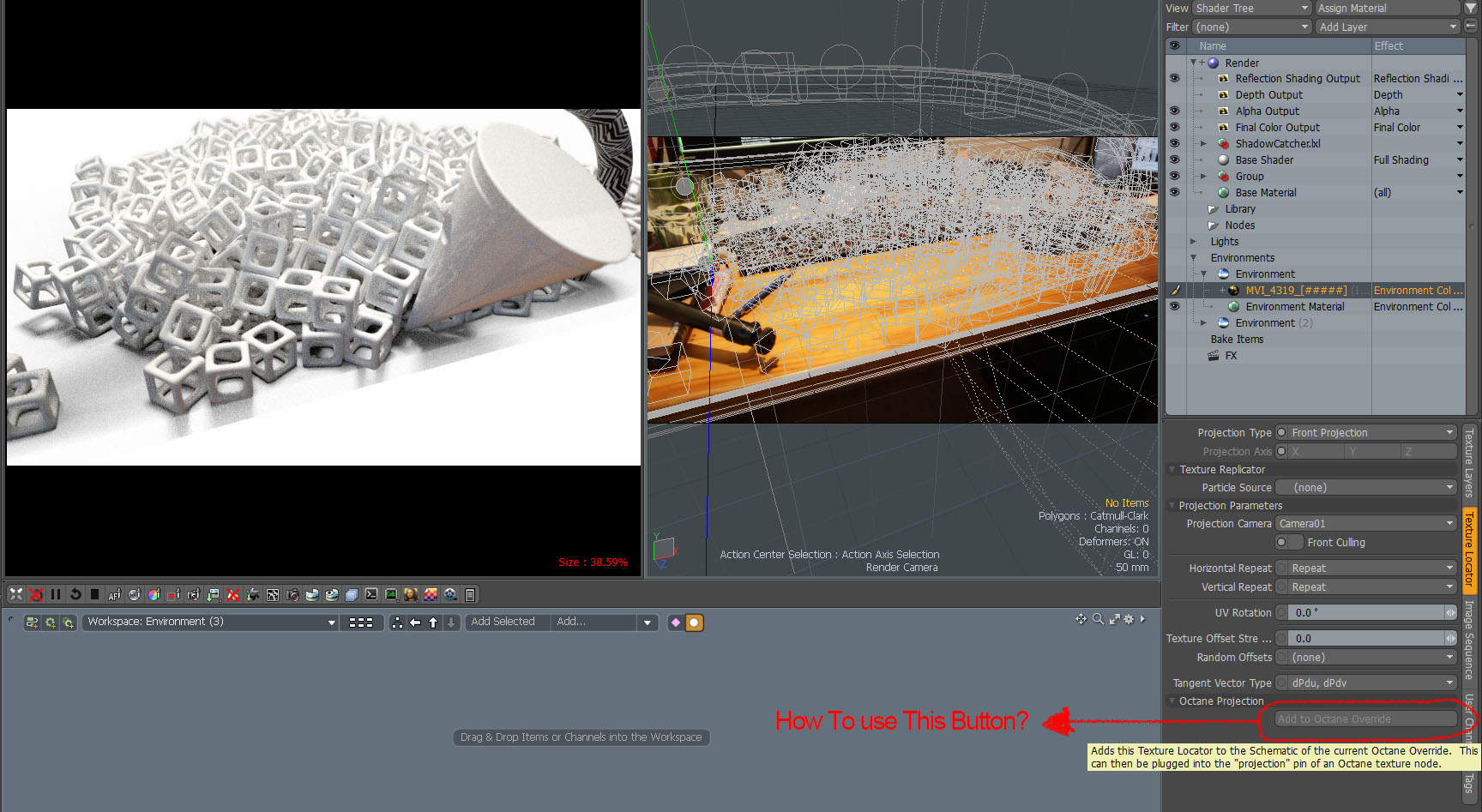

but, I can see the change projection type button.
This button is always deactivate. I can't touch this button.
Can you post a screenshot of the button pls?
I want to use 2 environment map.
1 HDR map (projection type light prob)
2 sequential file(projection type camera projection)(live action image).
I doubt this is possible with Octane. It allows for a Visible environment and a Lighting environment, and these can be different texturemaps, but I think you want something else? I don't full understand what you are asking.

I want to use Sequence File in Environment Color texture.
I know Can use Sequence File in material.but, I can't use in Environment.
Am I missing something?
And,I want to use projection type of Front projection in Environment.
I attached screenshot.
I uploaded my scene File.
Would you check my scene File?
https://drive.google.com/open?id=0B9g-9 ... 0JvVFd1OWs
BR

Have you tried the approach outlined at the start of this tutorial to gain full access to the Environment Textures?
https://youtu.be/z9h1czU1IaQ
In your scene you have the visible background set to a Front Projection camera. Whilst this is supported by the plugin for materials, it is not supported for the Environment texture. Instead, enable Kernel->Alpha Channel and use Photoshop, Gimp, etc to paste the rendered image over your background.
