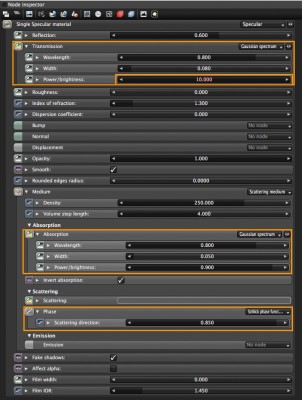

Posts: 10590
Hi jerzer,
finally I have found the time to look at your scene.
Here is my version with only one Specular material instead of a mix material.
If you use a Gausssian spectrum node, instead of an RGB node, you can easily use a value greater than 1 in the power pin. Playing with the Phase value, helps to reduce the transition between the colors:
SSS-b2.orbx.zip
(19.9 MiB) Downloaded 444 times
In general, with Specular material and SSS, better to switch to PMC kernel, instead of Path Tracing.
