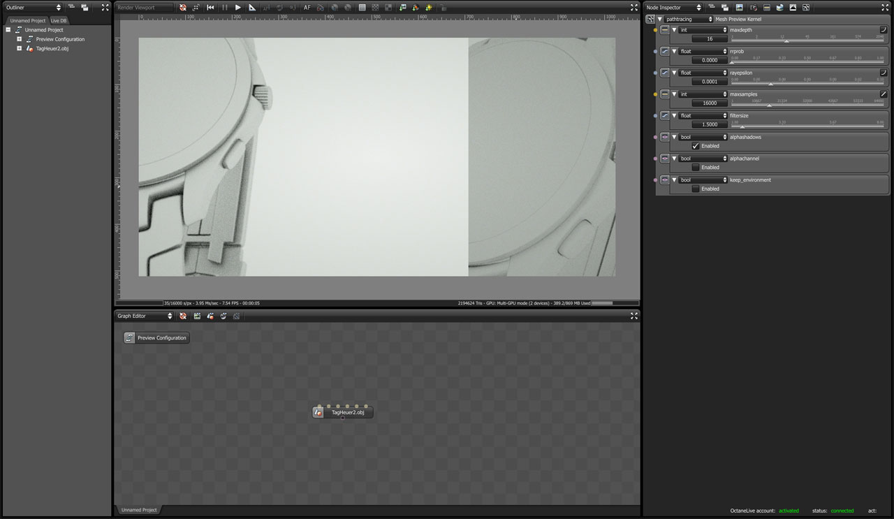

Hey guys,
just bought Octane a few days ago, and now i wanted to test out some of my xsi scenes. But i got a strange problem with the exporter (i think).
When i'm exporting an object an load it into a Octane, and change the preview kernel to pathtracing, i only see 1/3 at the right of the render viewport. With directlight everything is fine. When i'm exporting with the standard built-in .obj export of Softimage i don't have this problem, but therefore i don't have the smoothed subdivided geometry.
I hope someone can help me with this problem. I attached a screenshot so you can get an idea of what i'm meaning.
P.S. I got Softimage 2011 SP1 x64.
Greets Mugga

Hm, the camera data which are submitted to Octane, is the same in directlight and pathtracing.
I see that you use a multi GPU-System.
Try to test pathtracing with a single GPU. Looks like and Octane issue.
And maybe you can change your Octane version to an other Cuda release.
You say, you haven´t the effect with the standard obj-export.
Are you change the gpu-devices there too, to multi GPU, after the import in Octane?
And which GPU´s you use?
I will post it in the Commercial Product News & Releases thread.
face

Hey face,
thanks for your reply.
I tested a little bit further, and i only have this problem with this model. I tested a few other models with your exporter and there is no problem with the pathtracing.
I think that it has something to do with the alphachannel. Because when i activate the "alphachannel" in the pathtracing mode, the left side is completly transparent. Then i tried to turn of the "auto alpha image" in the mesh import options tab. But then the whole screen is black or "transparent checkerd" when i hit the alphachannel button in the pathtracing tab.
I also merged the model into another scene in xsi and deleted all materials an set them new (only phong). But the same problem. Another thing i figured out, is that octane crashes when i try to import a model with "null-objects" and not freezed texture projection maps. But this should be an octane related issue.
Edit: Ah i forgot to answer your question face... I just tested the whole multi-gpu thing but then i saw that at the moment it's only working right with Cuda 3.0 (which i doesn't use). But i already reversed to one gpu (260gtx) but i have the same metioned problem. Here my specs if this helps: CPU Q6600, Nvidia 260GTX, Nvidia 430, 8GB Ram, Win7x64.
Intel i5 2500k@4,5 Ghz | Asus P8Z86-V Pro | 16GB DDR3-Ram | Nvidia 580GTX GDDR 3GB | Win7x64 | Softimage 2011 SP1 x64 | Octane 2.52 x64
Crasy thing...
Can you send me the Softimage scene via pm?
face
face
