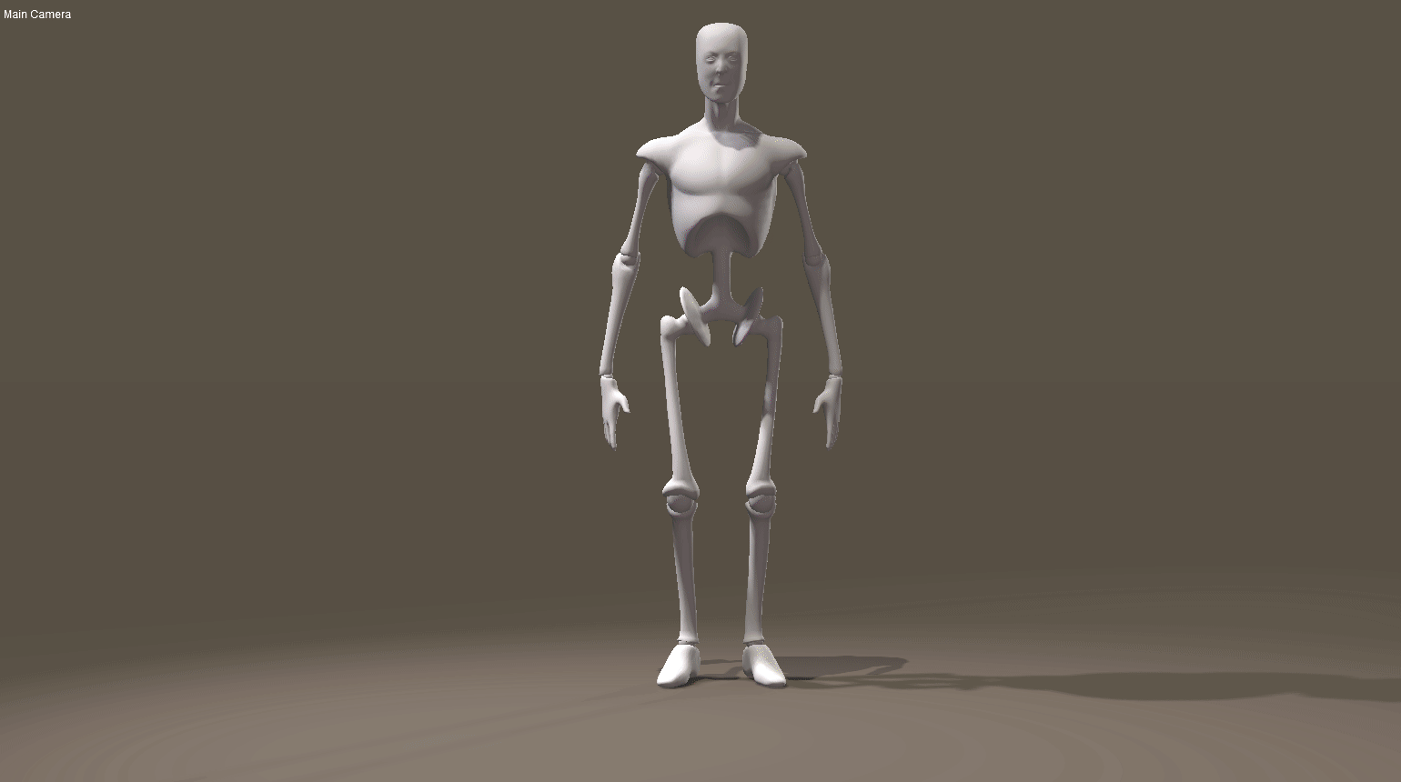

It happens every time. Nothing has to be in the scene.
here is a gif.
man it is late.... have a good night.
here is a gif.

Thanks. I'm running Nvidia driver 365.19, and have not had a driver crash - and we have very similar hardware. Have you overclocked your card? Try underclocking as per the link in my signature. Also try removing the other card - just to make sure it's not causing the problem.It happens every time. Nothing has to be in the scene.
Paul
