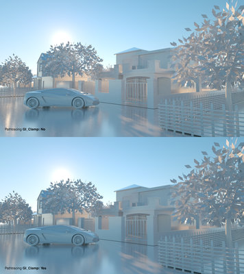

A test for new parameter "GI clamp", on PT and PMC. It's very usefull to get clean results.
