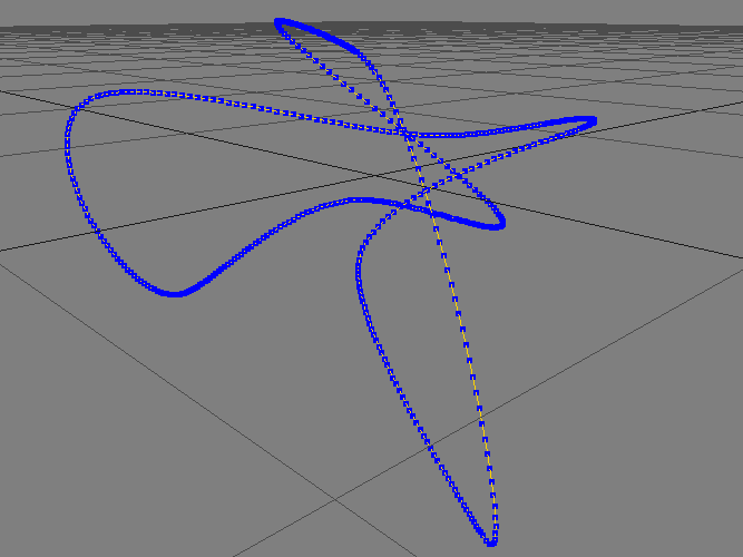

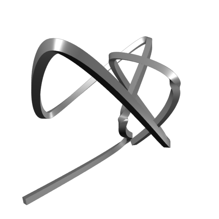

Here a look from the current state...

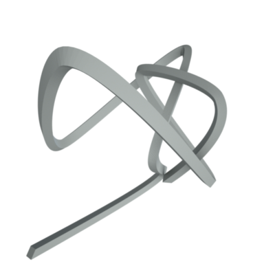

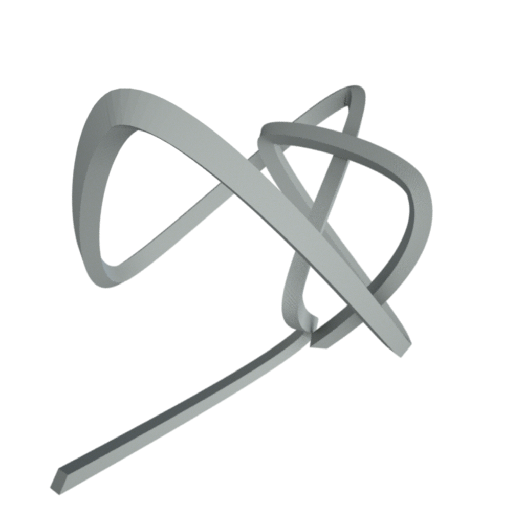

This is a strand rendered in Mental Ray. Here you see a recalculated strand with ICE. I use for that 2000 particles and the "Fit Bezier Curve" compound.
The bottom looks a little bit diferent, thats because the new export will have an option to close a strand if the start and endpoint match. And this is the reimported obj from the plugin.
It matches 1:1 to the ICE one. It matches also to the MR one if I export it as an open strand. Hope you like it...

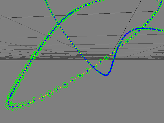

An overlay with the reimported strand and the ICE one, 500 particles.

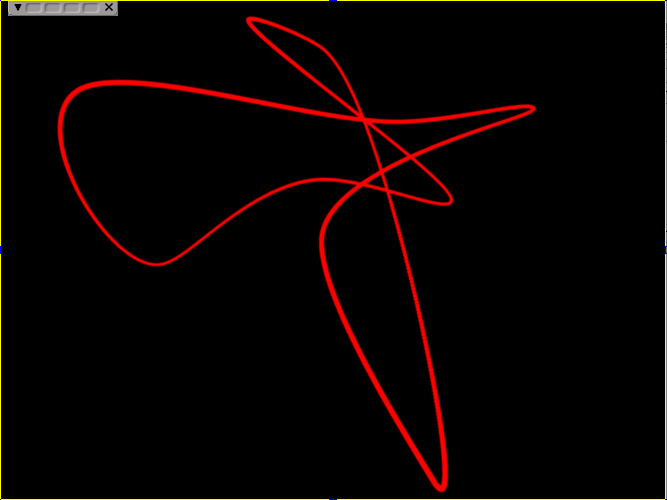

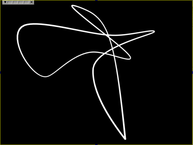

First strand test...
Looking good I think
