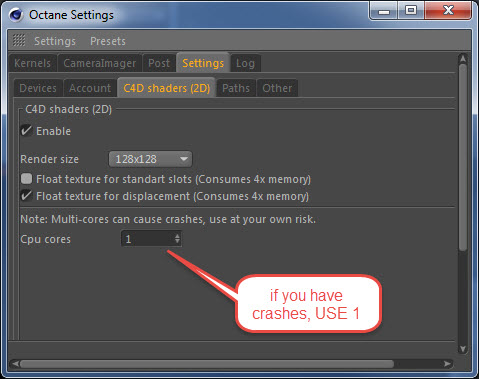

threads are new on development, i wished to see how is working. There is some problems which are related c4d's sdk and our workflow.
As you can read in section, has a note about that. Also default is 1 core. I hope to get some support and fix it.

ok, doesn't make any different to use or not. It triggers some preview calls. I can see the problem on part of multicore, as i expected. Set cpucores=1 to avoid crashes. I'll try to implement more reliable method.
If anyone has crashes on 2.03 please try first set cpu cores=1
