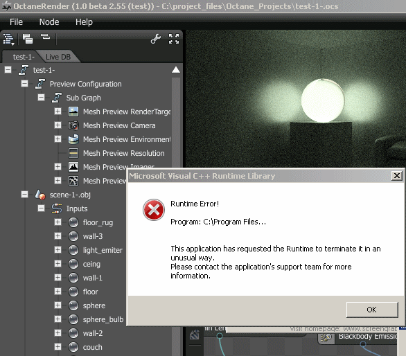

While just after clicking one my scene.obj I clicked on the re-import button (top right panel) and the following happened resulting in program crash, you prob need more detail/specs/info so feel free to ask away :)

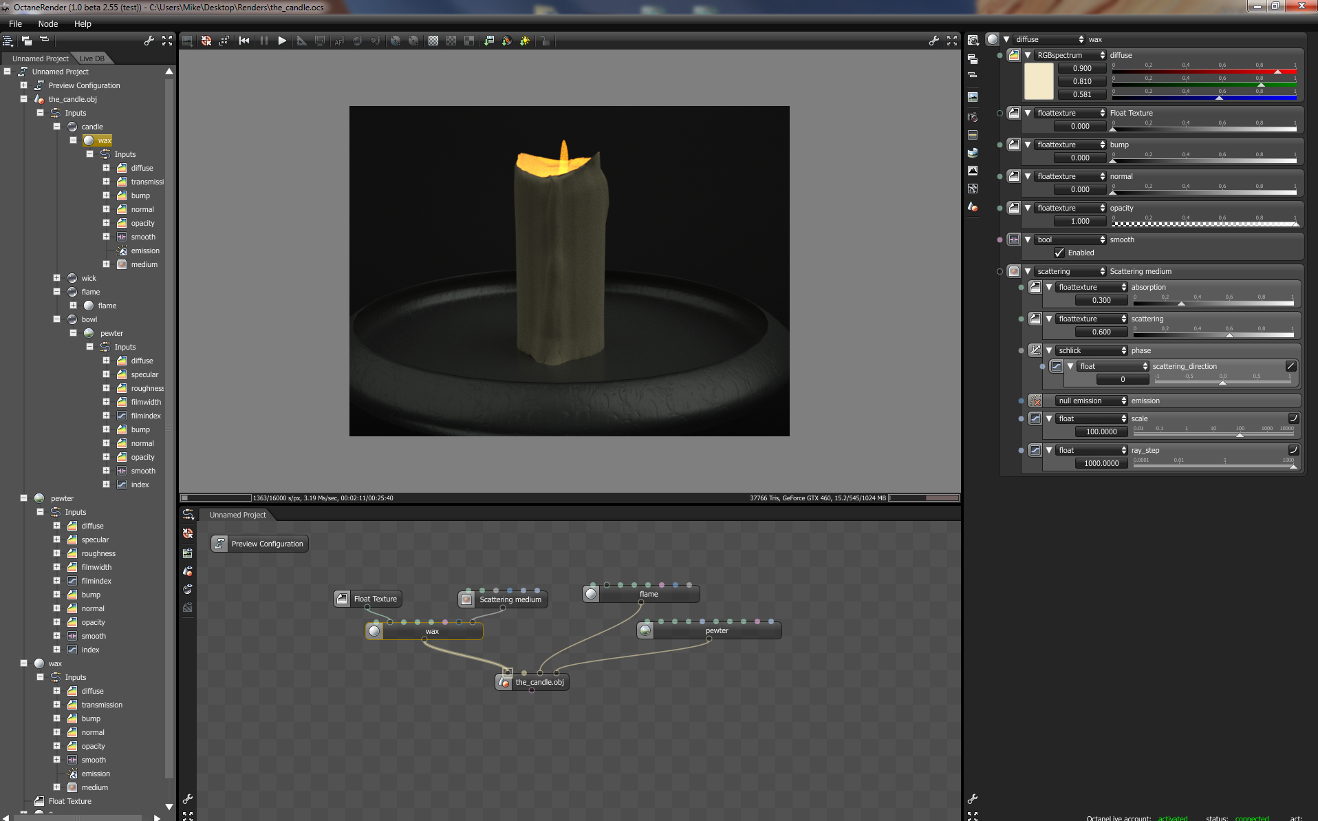

I've finally got a moment to try out this release .No bugs or crashes yet.
However I must be a bit thick. I cannot seem to get the SSS to work
See screen grab.
I thought I'd try a candle , but the wax doesn't seem much like......er....wax ! ;)
I'm probably doing something wrong , just not sure what.Any suggestions ?

Not to worry. Just spotted Roelands thread on SSS.
will take a look at that.

Swith to pathtracing or set the GI-Mode in the DirectLight Kernel to diffuse with depth 3-
