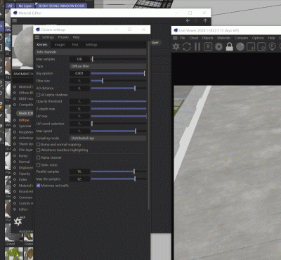

Using R2, I noticed using the Info Kernel, tweaking the settings, closing the window and reopening, the settings are back to default.
Regards,
Regards,
