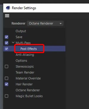

Otoy support was able to quickly diagnose and fix the render passes issue for me. We had the Save Flag for Post Effects enabled in Render Settings PLUS the Post AOV enabled. After removing the Post Effects in C4D render settings, everything is working fine now. I want to shout out Jay at Otoy support for blazing fast and accurate support!

Thank you, lightborne. This makes me feel a bit easier about upgrading the version I'm on (I assume you were using 2023.2) Really the only solution I've seen so far.
Makes me wonder, did the Post Effects option get turned on for everyone's system that was having problems? Hmmn.
