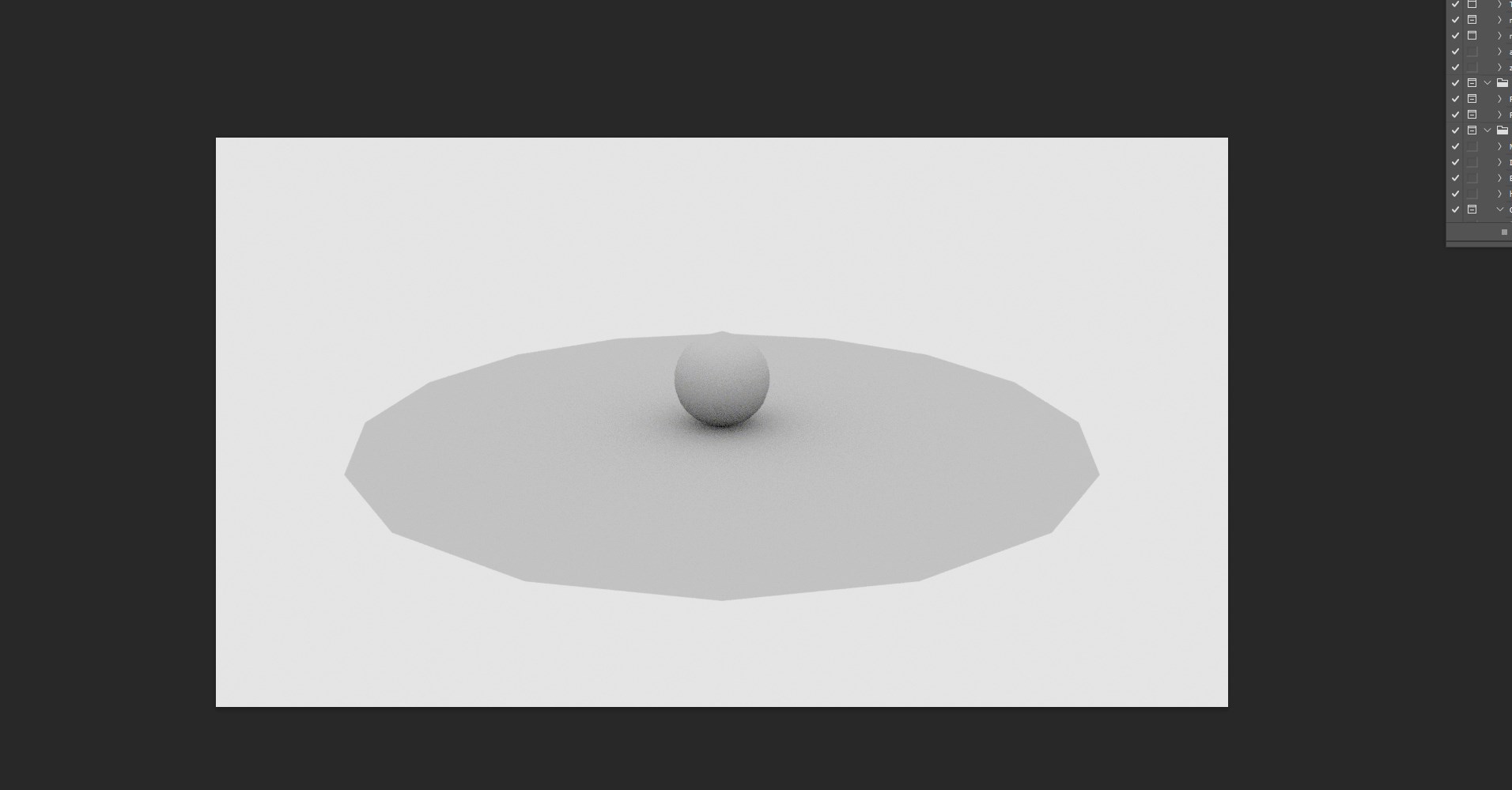

Apologies if this has been discussed already. When using Spot lights, with no medium enabled, there are artifacts where the outer edge of the cone interacts with geometry in the scene.

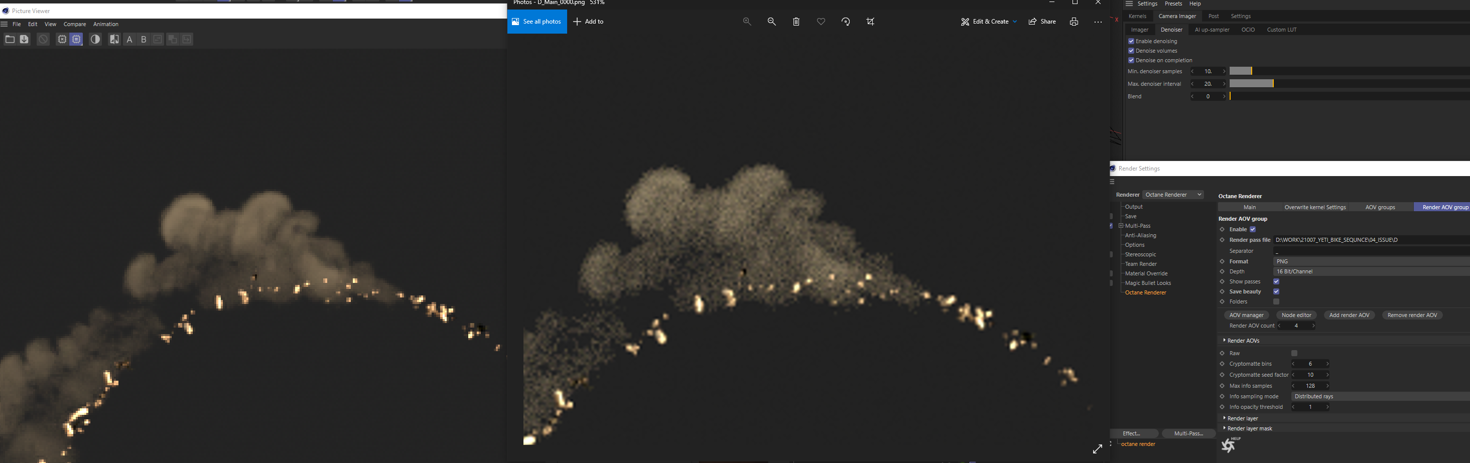

Denoised Beauty are not being outputed on the render passes.. Denoiser active, save beauty.. you can see the denoised result on the picture viewer, but the file on photoshop is the standart beauty
CFG:
PS:

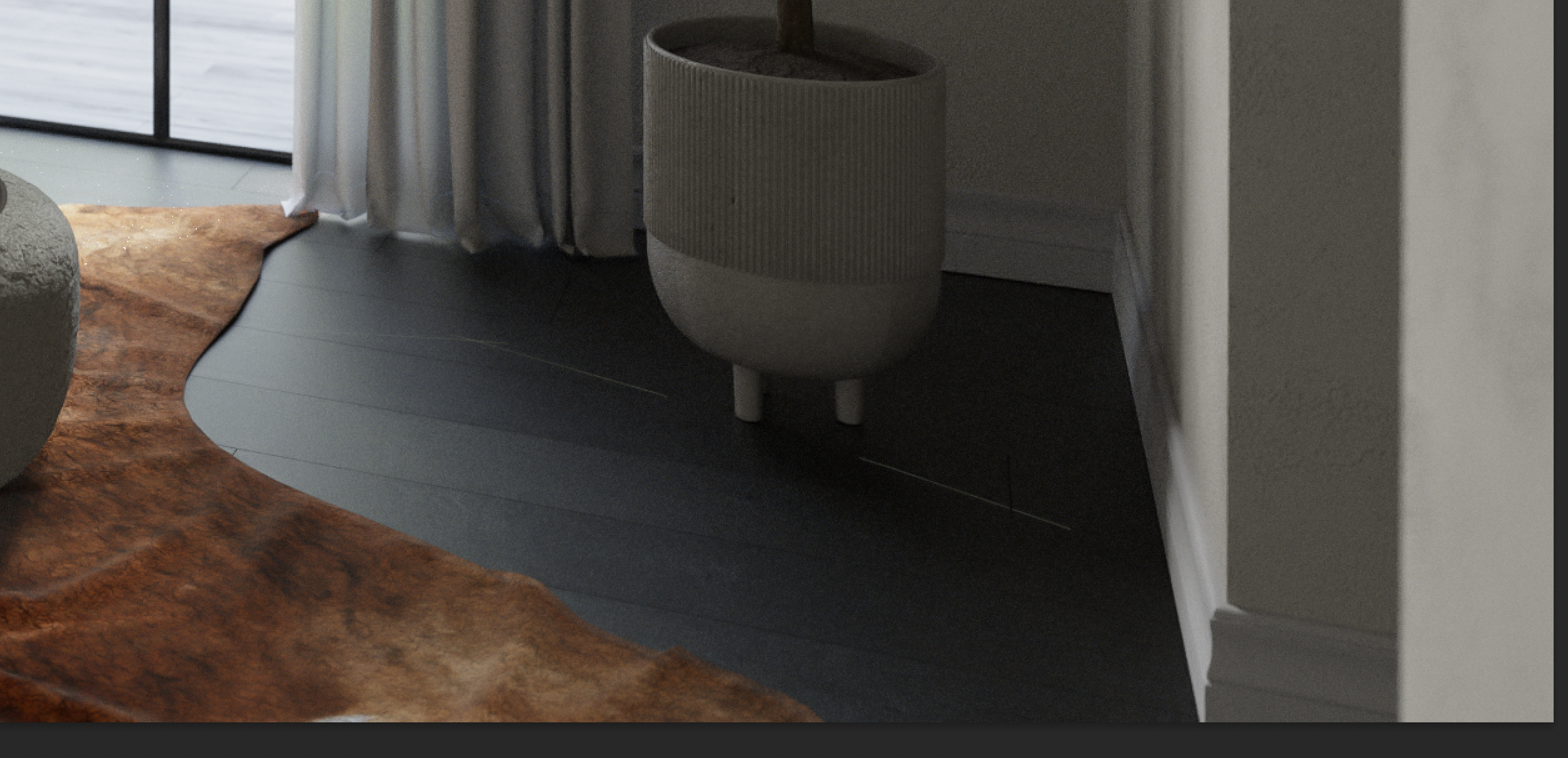

marcus1070 wrote:Denoised Beauty are not being outputed on the render passes.. Denoiser active, save beauty.. you can see the denoised result on the picture viewer, but the file on photoshop is the standart beauty
CFG:
PS:
the Light-Pass "Sun" not outputted as well!
