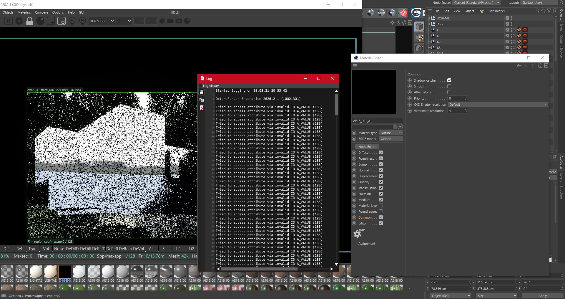

I was playing with shaders and diffuse, Octane crashed after activating "Shadow catcher". Please refer to LOG and image.
Regards,
octane 2020.2.1 210315 223444.log
(16.26 KiB) Downloaded 203 times

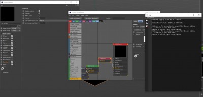

Same here, if Material has a gradient in opacity channel --> activate shadow catcher --> crash
But except of this, good job Aoktar!
