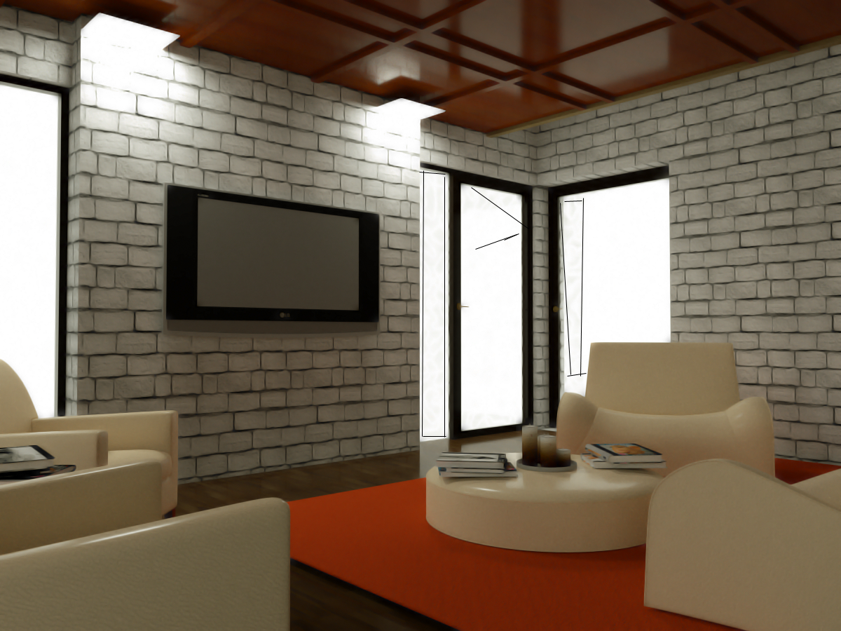

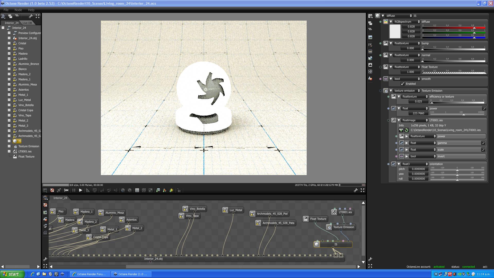

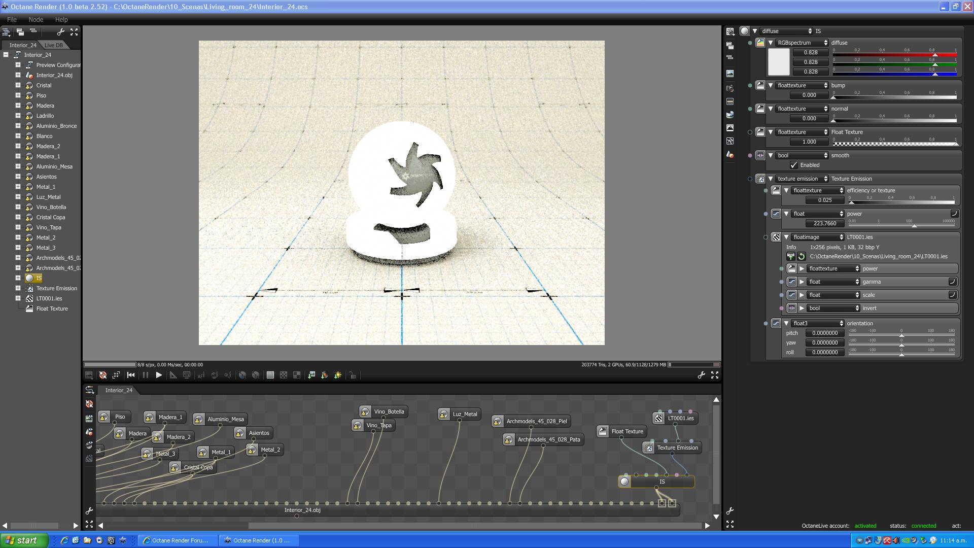

hi radiant, i been done all about your tutorial light and just looks like your ies, i been used an erco lights and appear like in the image, could you told me the reason ? i add material
thank you
seetings of materials

hi radiant my problem is the ies i can't see the light like yours, i mean, none light just a slow brigth
i been put a lot ies and is the same result, maybe an tutorial with a scene will be better, becouse box and gems without roof isn't the same or some explanation to understand more this topic about ies ?
regards

What are the settings for your emitters? Are you adding the IES data to the correct pin (i.e. the distribution pin) ? Or can you post a screenshot of your settings and rendered image?
Roeland
