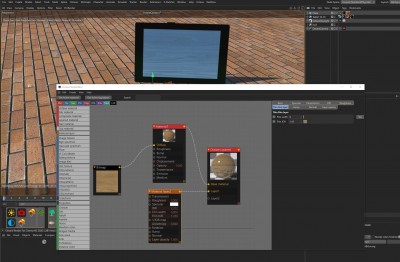

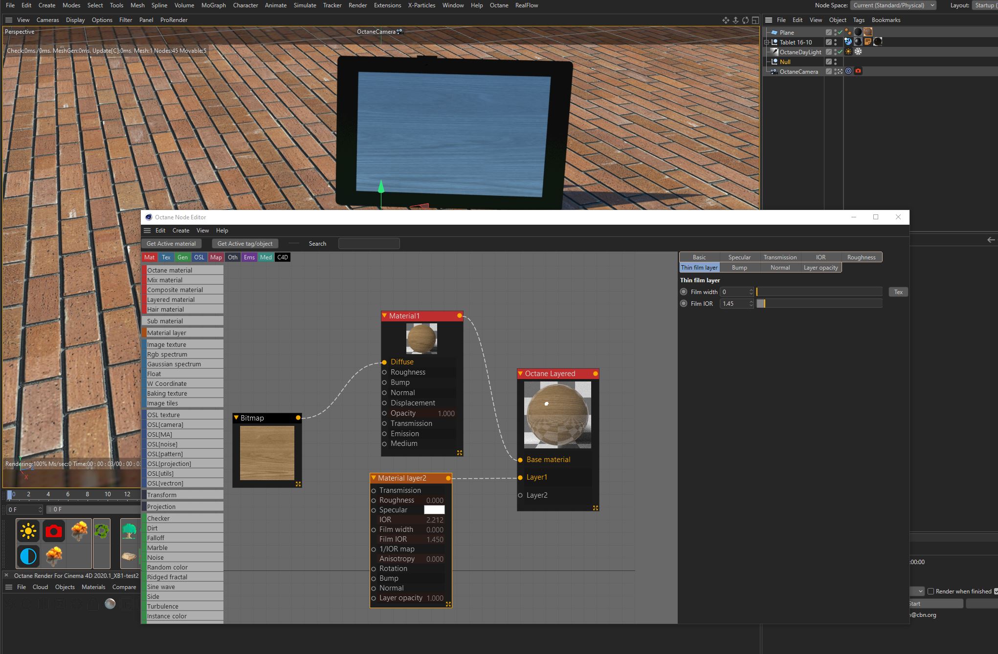

This may be a kernel issue, but I'm getting an odd response with a layered material that I've been using to emulate a piece of glass over video on a tablet.
It worked fine in 2019.1.4, but when I try to render it in 2020.1 it turns the base layer monochromatic. If I disconnect the specular layer it returns to full color. I've tried every tab to see if there's just a setting that's different, but nothing works.
You can even see what it should like in the render inside the node editor. Pic below:
