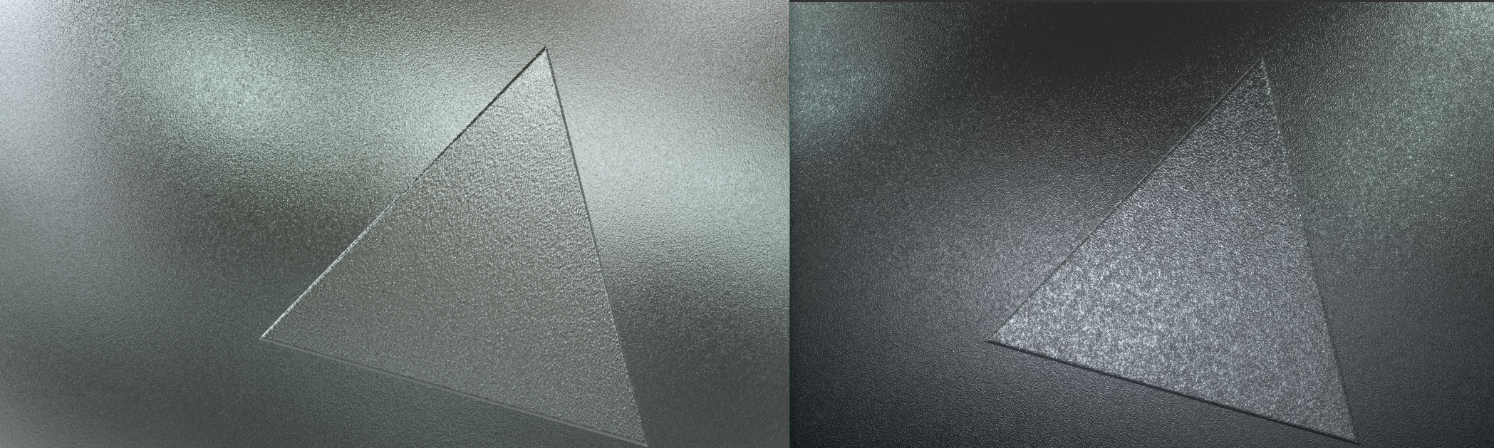

When working on small scale objects with really fine bump maps Octane loses detail after scaling down past .1 in transforms. Here is a comparison between octane and redshift. I asked about this earlier and it was just ignored.
I've noticed a similar thing too.
Question for you if you dont mind, is this happening only if you use the transform "commands" or is it happening when having scaling the UV mapping really low too?
It is only when you say need to use a triplanar mapping and have to lower the transforms in the octane node itself.

I'm still not sure I can see it. It definitely looks like the original image you sent you took a screenshot of perhaps windows picture viewer? It applies a nasty blur to anything you view, even at 100% zoom. I re-rendered it with a slightly higher exposure (attached). Seems to me the lighting is too different to make a comparisonsethRichardson wrote:Surehaze wrote:Could I please have an ORBX of this scene, so that I can be sure I'm understanding what scale exactly we're talking about?sethRichardson wrote:This has been a problem since well forever. Can we please get this fixed.
