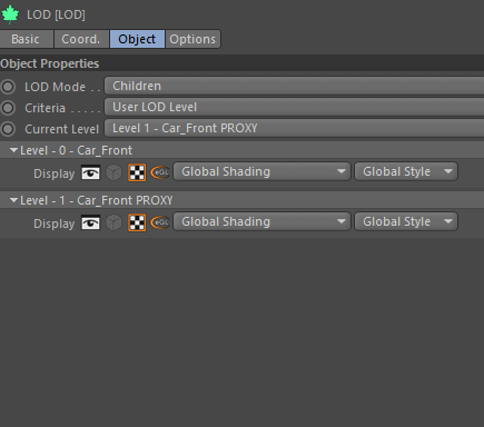

Hi aoktar,
I see that this version has support for Cinema 4D's LOD object. I am using it, but the "Use LOD 0 for Rendering" checkbox in the Options tab does not seem to work. This feature is very useful for cases where all Viewport geometry is low poly and only Octane will get the high poly models.
Object Manager
Object Manager
Attributes Manager
Attributes Manager
LOD Options Tab
LOD Options Tab
My current setup does work with Cinema 4D's renderers.
Thank you.

blastframe wrote:Hi aoktar,
Thank you.
Just dropping a note for someone else, It's working as I said in a different topic. But parameter is active for rendering and LV is based on viewport geometry data and you can't see the same result. Expected result will be seen in Picture Viewer.

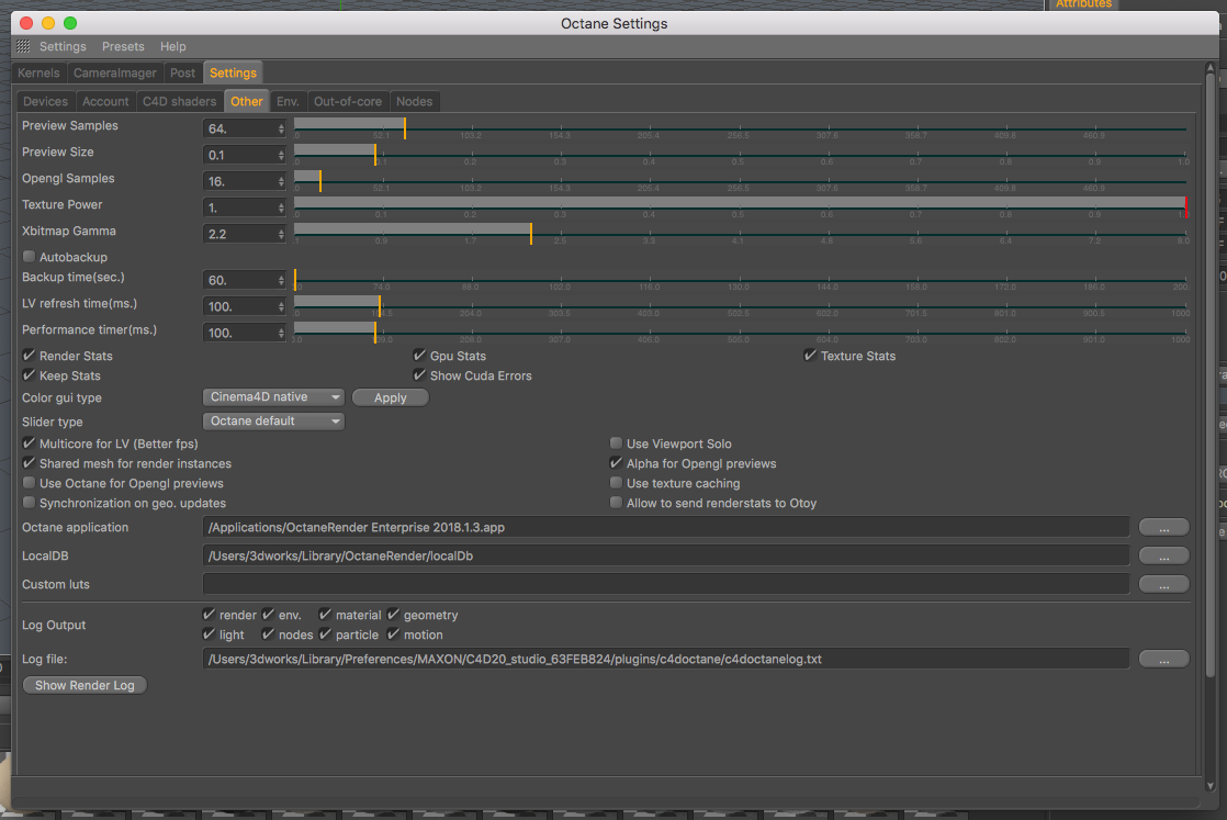

i didn't get any feedback from you for some time, but this issue was really making work with octane almost impossible for larger commercial projects. i was about to give it up and look for other engines, but finally found out that the "texture cache" function might be the problem.
when "use texture caching" in "other" settings is enabled, the live viewer build in my current project scene is more than 5 minutes (!) when restarting the render. if i disable it, previews will be always fast as the first one and about 20 seconds. all my textures are directly acessible in local folder "tex", no NAS or remote acesses. seems to be a bug in cinema or in your code. can you please investigate about it? i'm happy to supply scenes etc.

3dworks wrote: i didn't get any feedback from you for some time, but this issue was really making work with octane almost impossible for larger commercial projects. i was about to give it up and look for other engines, but finally found out that the "texture cache" function might be the problem.
I was off by summer vacation time by time. I don't have problems with "use texture caching". Probably because I don't make extreme scenes with heavy texturing. Use it disabled if solves. It actually stores all used textures in memory and can cause out-of-memory or windows caching. So can slow down the things. Anyway provide some extra information/scene to me by PM.

unfortunatley, it was not the solution to switch this option off. after working more today on the same scene again, i got the same slow down, even with the option set to off. when sending to live viewer, there is again the orange status line about "check: 7ms/8ms. mats movable:0 txcached:0" and second line: "export materials convert mat: xxxx" - and each material will take about 5/7 seconds. i will provide scene and logs and maybe a screen recording later this week and send it to you as PM. thanks for caring.

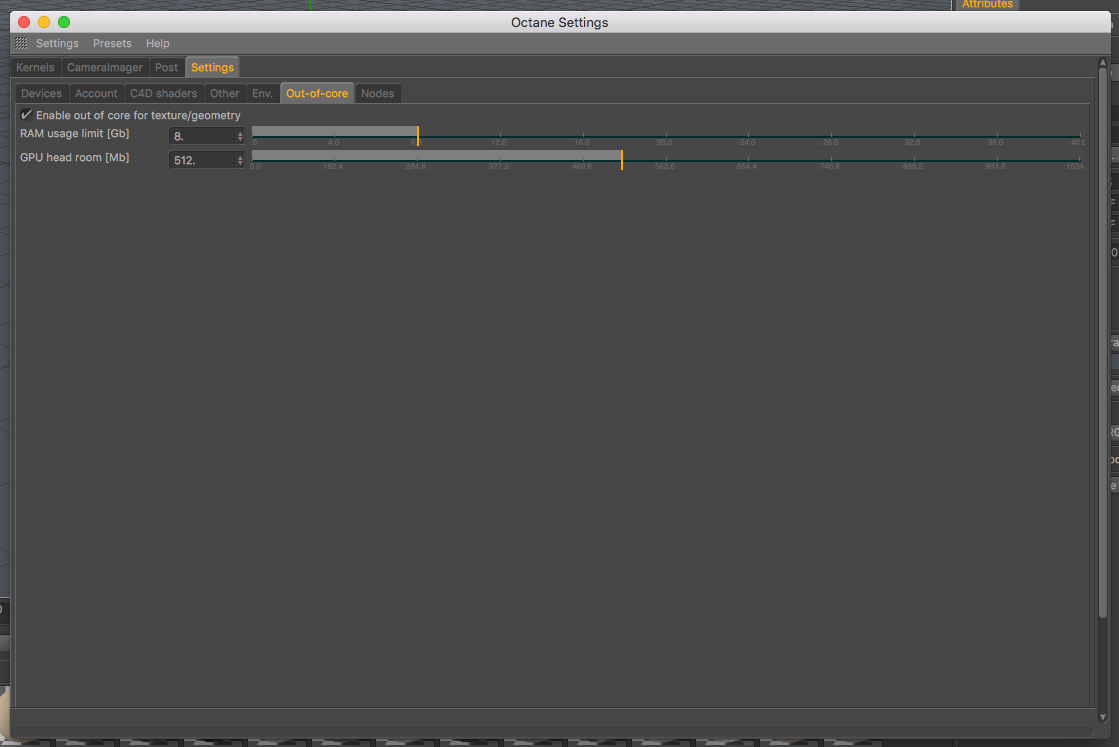

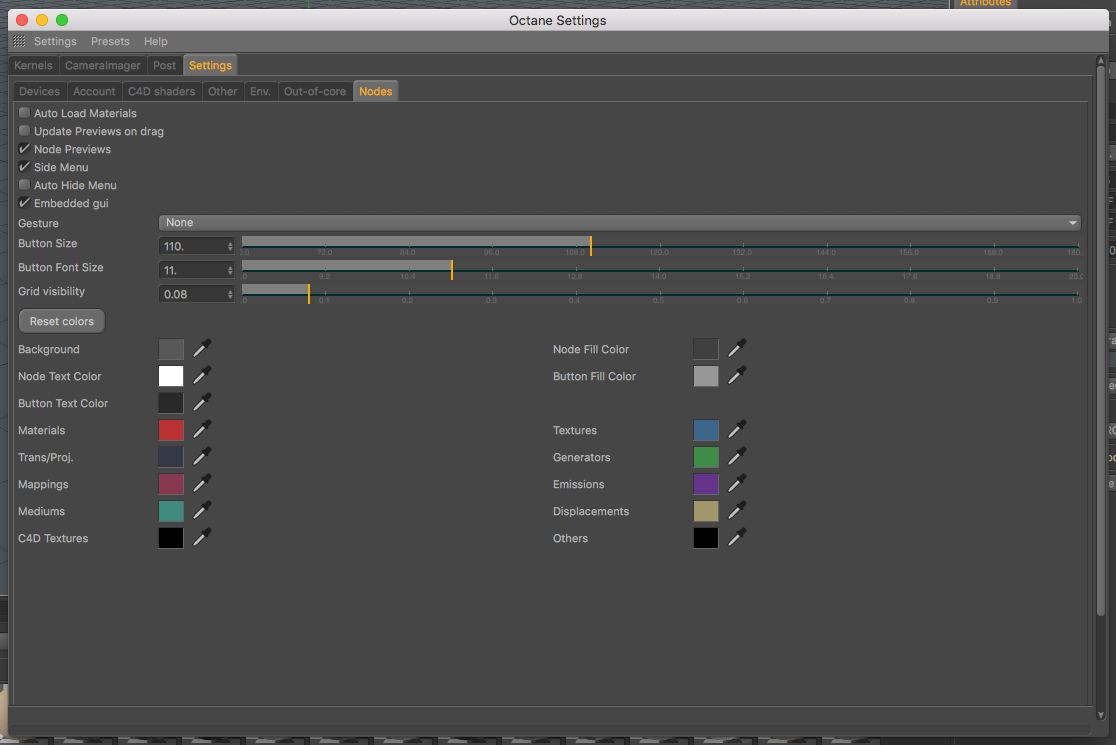

i am also increasingly having another issue in my latest project. when i am editing a material in the node editor, i often get C4D hanging while editing a node. i am only using the node editor because used to it, never do wediting in the layered material mode. when i am schanging a node or applying to a material tag, the beachball starts to spin and usually i get aplugi status like the the screenshots.
Screen Shot 2019-08-12 at 09.57.55.png (11.26 KiB) Viewed 4392 times
last operation was to create a blend material, but it also happens when simply editing a texture connection of existing node or just dragging a node to a tag.

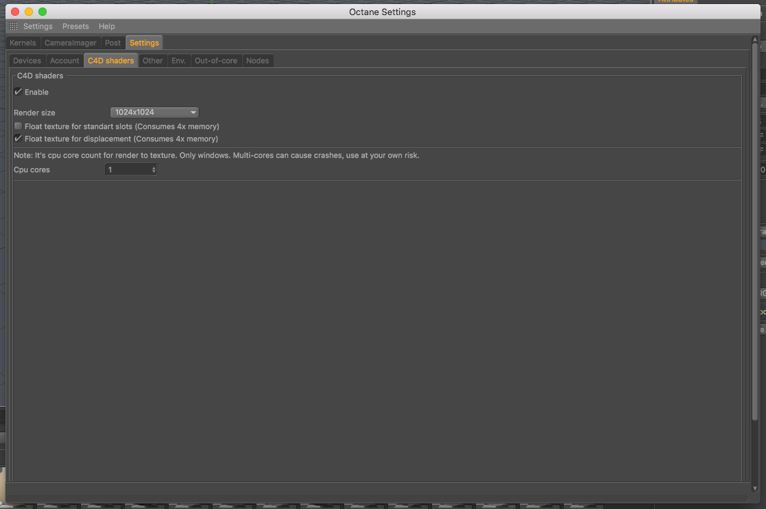

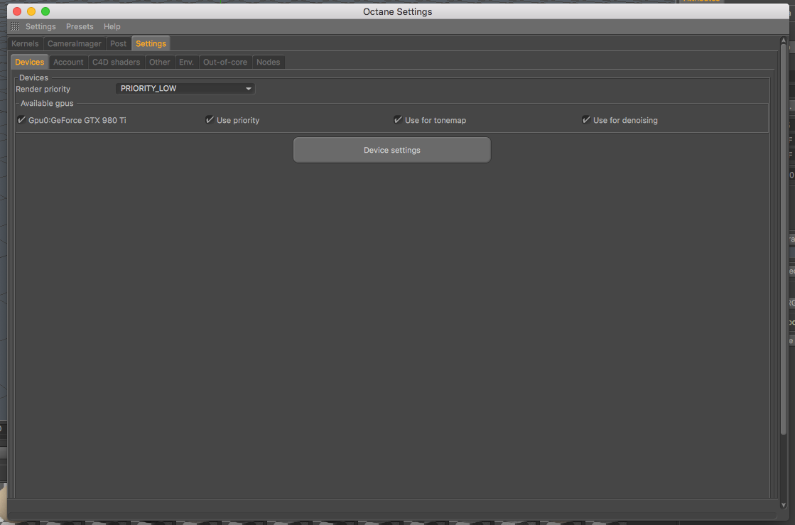

i did disable octane/ opengl previews in viewport and node editor to check if is will help, but it does not change crash behavior.
any tip what i could do to to get less crashes? since i am working on the latest project i cannot edit nodes without crashing every 5/10 minutes.
here all my octane settings as screenshots, maybe i'm doing something wrong?
