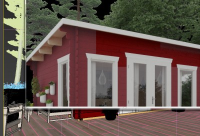

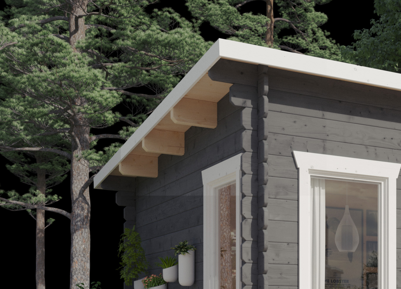

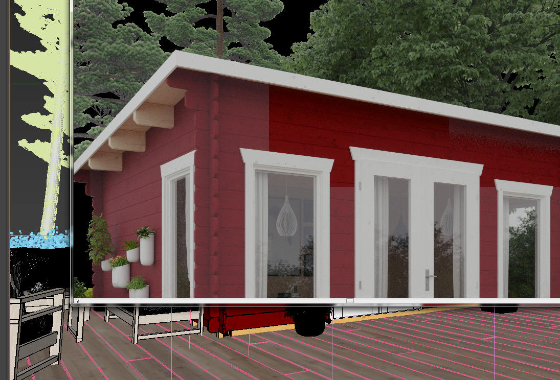

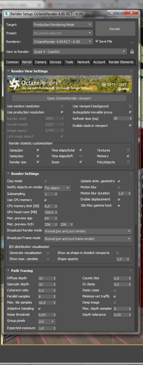

I got new bug. :?
Three scenes. All the same. Only one material has different colors.
I batch render the three scenes but final render got visible squares on image.
Plus the red version suddenly has no HDR loaded and flat lighting.
When I render the red color variation not with "production" but "interactive viewport" all is fine.
Denoiser and texture compression in not active in this scene. But I checked the "use denoised beauty" in preferences. Maybe the tool doesn't take into account when I disabled denoised in a scene? It should use the "beauty" pass if denoiser is off. But should use denoised beauty pass if denoiser is turned on in the scene.

paride4331
Posts: 4001
mbetke wrote:I got new bug. :?

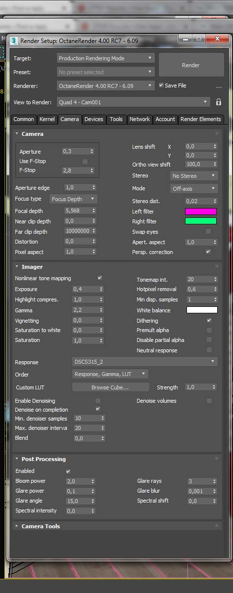

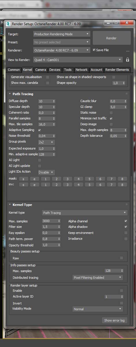

Hi mbetke,
could you share a screenshot about Render setting, kernel type and path Tracing panel please?
Regards
Paride

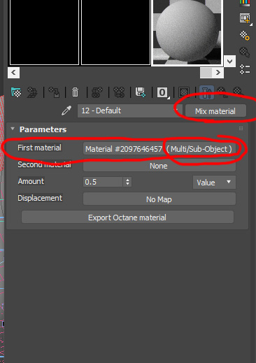

Hi Paride,
can we finally have multi/subobject material inside the mix material since octane now support OSL?
is it possible
mbetke
Posts: 1307
Location: Germany
Hi mbetke,
Regards
Paride
See attachment. :)
Pretty common settings. Nothing special and I use on a lot of scenes. I don't render on the network.

paride4331
Posts: 4001
Hi mbetke,
it would look like a network render issue using minize traffic, but you said do not do network render., do you have any textures on server or cloud or are you using .psd textures?
Regards
Paride
