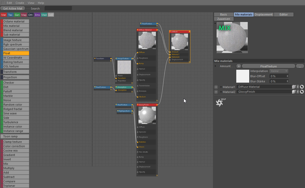

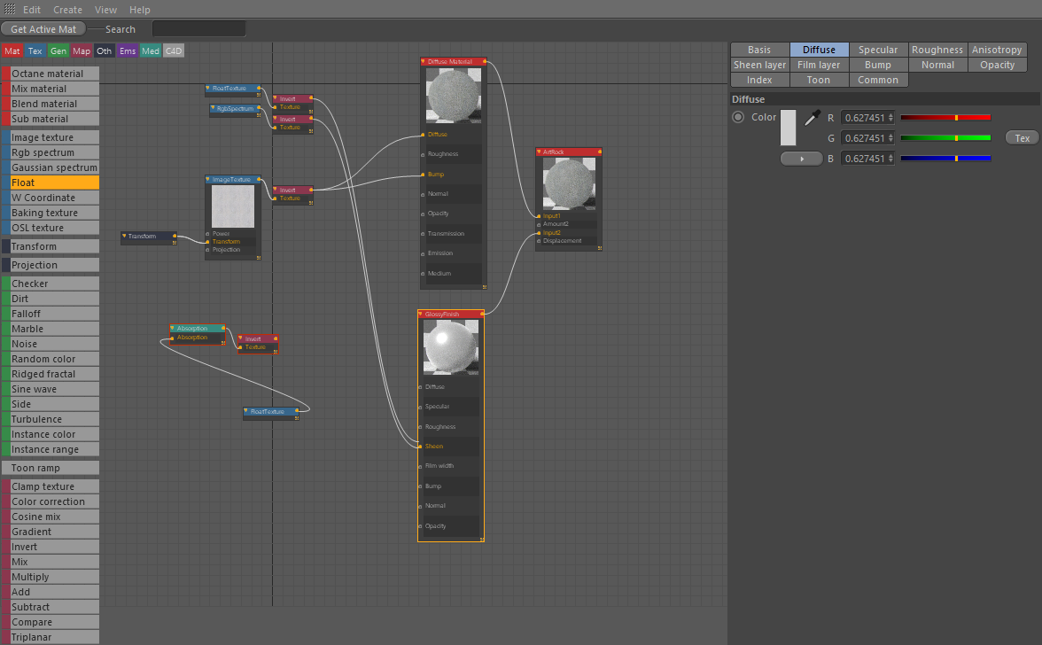

Hi Ahmet,
thanks for this new version! I really appreciate the Mix-Mat converter!
But: there is an issue with converted materials: it shows invert nodes that are unneccesary, orphaned nodes and wrong node assignement- see screenshots.
I checked several mix mats and got always this issues.
Thanks and keep up your awesome work!
Ron
Converted Blend Mat
Converted Blend Mat
Original Mix Mat
Original Mix Mat

Ron wrote:Hi Ahmet,
Ron
Invert nodes are required to provide same results. Bwcause blend material's order is reversed. I'll check for other issues.

aoktar wrote: Invert nodes are required to provide same results. Bwcause blend material's order is reversed. I'll check for other issues.
Sounds strange. In my tests the results were different with invert nodes and after deleting those the results have been quasi the same as mix mats.
Could you send me a few examples. So I can check. Thanks.

aoktar wrote: Could you send me a few examples. So I can check. Thanks.
I used some of the mix mats from liveDB/Stone. I tried the Asphalt and some others - maybe sending those is not necessary?
