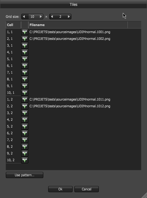

roeland wrote:
calus wrote:So it's possible in the Image Tiles Texture node to setup a pattern for most of the UV tile naming conventions,
except for the UDIM convention ?
You can set it up as follows:
  • The grid is 10 tiles wide.
  • Use the %i placeholder for single index
  • Set the start index to 1001
  • 4 digits.
Oh I see,
thanks Roeland.
sorry I was expecting the "use pattern" tool to detect the needed grid size by itself (and optimize it).
So the way it works can generate many empty grid cell,
for example for just 2 rows of 2 tiles, so 4 tiles, 20 grid cell are needed.
Is it Ok, optimization wise, to have many empty grid cell ?

roeland
Posts: 1826
calus wrote:Oh I see,
thanks Roeland.
That is OK, the empty cells will not have much overhead.
Is it common to use only a few columns in an UDIM grid?
calus
Posts: 1308
Location: Paris
roeland wrote: Is it common to use only a few columns in an UDIM grid?
Not so much but using different rows to organize different meaningful group of UV tiles is rather common, so you can get some of the rows with a only a few tiles.
Pascal ANDRE
