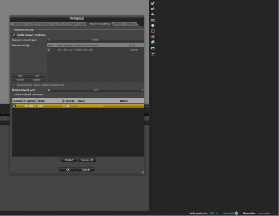

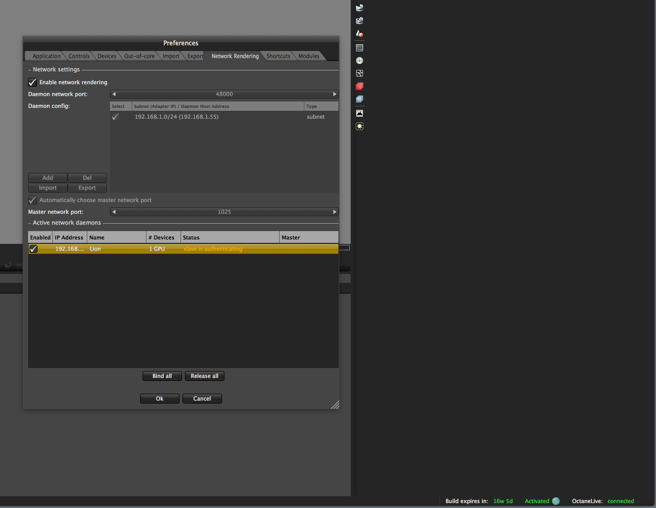

unfortunately, the crash issue is not solved completely. it is working well with only one workstation active. but as soon as i enable my networked mac with macos or pc with windows, the new version of app will have exactly the same crash as before (with decompressing thread crashing). same issue as well with the LW plugin, it will crash as soon as i enable it. when i shutdown all network machines, all is back to normal again.abstrax wrote:Just for your information: We just updated the release builds for OSX and Linux since various people reported that Octane crashes during startup after the cuDNN library was downloaded. Please let us know if the problem persists even with this build.
Specs: Apple MacBook Pro M1 max 64GB 2TB, MacOS 12.5 / MacPro 5,1 with NVIDIA GeForce GTX 1080 8G, MacOS 10.13.6 / Mac Pro 5,1 with AMD RX5700 8G, MacOS 12.3.1 / HP Z600 with NVIDIA 3060 RTX 12G, Windows 10 pro + Netstor GPU box, 4 x NVIDIA GTX 980ti 6G.
i made a further experiment with the crash issue when RC4 is networked. if i disable networking inside the octane app and start the app with a networked machine running a slave, i will have no crash. when i enable networking on the local workstation, as soon as i select the node with the checkbox, and it tries tho authenticate, the app crashes. see screenshot before the crash.
