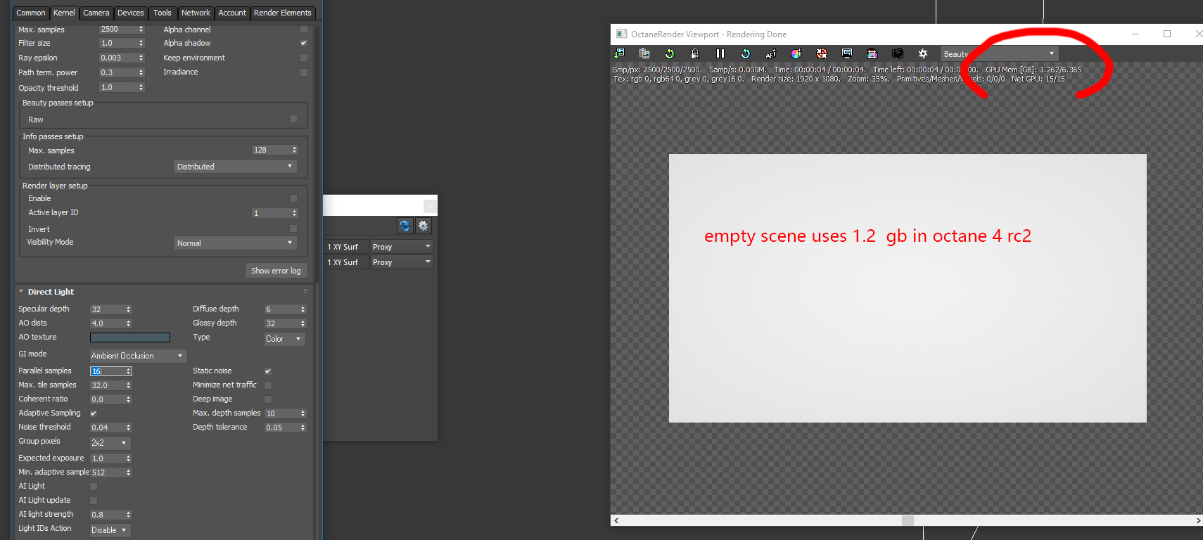

empty scene uses 1.2 gb octane 3ds max

coilbook wrote:empty scene uses 1.2 gb octane 3ds max
What is your Parallel Samples setting? If mine is set to 1, then Octane uses 51.3MB for an empty scene. If I set it to the new max of 32, then it'll use roughly 32 times that ie around 1400MB. If you have enough VRAM, increasing parallel samples helps render speed. If you don't have a lot, then you should use 8 or 16.
