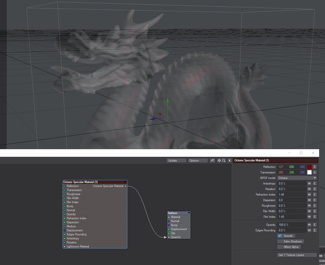

BorisGoreta wrote:Transmission value of a specular material is affecting OpenGL transparency. Since this value is often 100% these objects are invisible in the viewport.
I've fixed this issue for the next plugin build to make the object always slightly visible.
Thanks,
-Juanjo
