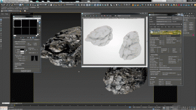

material converter crashes 3ds max

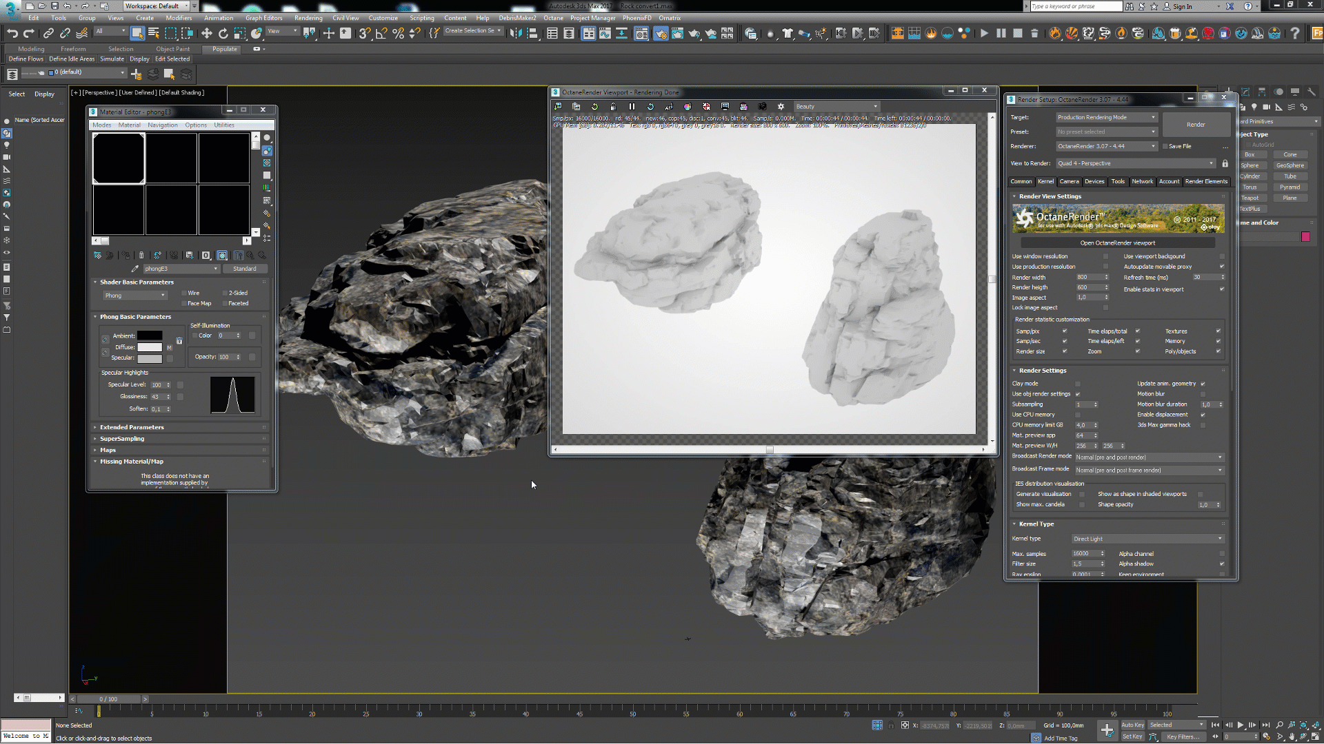

Hi Elvissupertstar007,Elvissuperstar007 wrote:material converter crashes 3ds max
I do not know about your issue, converter seems to work well, as you can see on video. converted scene attached.
Regards
Paride

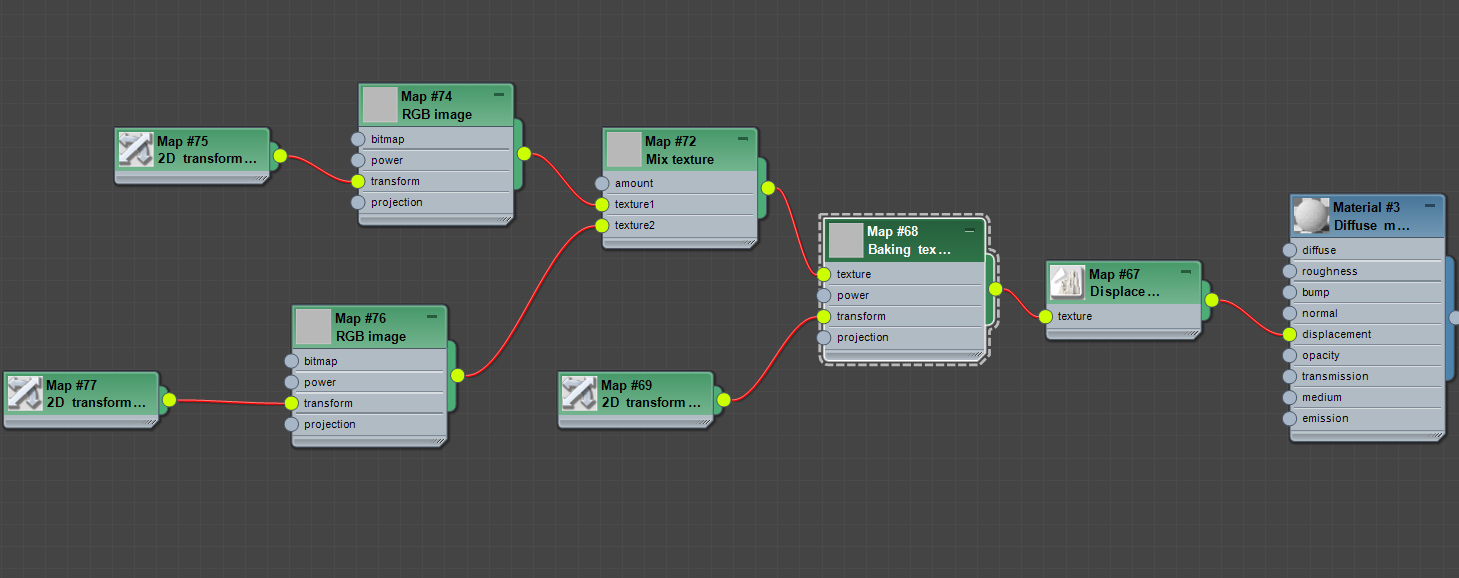

Mix displacement ! Triplanar displacement! Octane projections texture displacement! these functions will work?

Hi Elvissuperstar007,Elvissuperstar007 wrote:Mix displacement ! Triplanar displacement! Octane projections texture displacement! these functions will work?
you should use baking texture node in displacement texture node.
Regards
Paride
