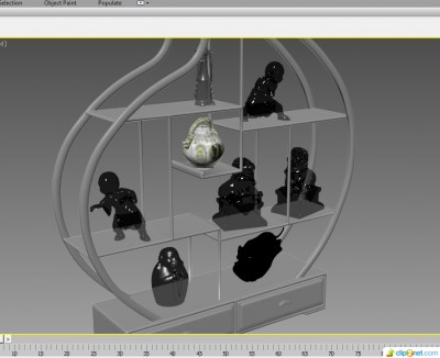

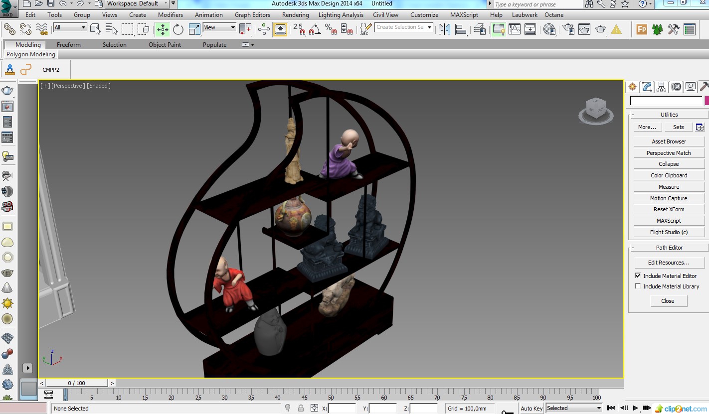

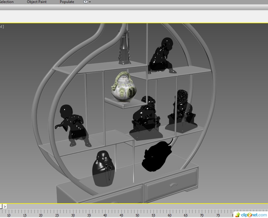

Converter does not work Vray to Octane , I get the glass
Here is the scene
Look at the Fstorm render! He correctly converts all, octane can not convert one render Vray normally. Fstorm and the Corona work, Fstorm correctly converts the Corona and Vray.Octane 2017 year!))
Here is the scene

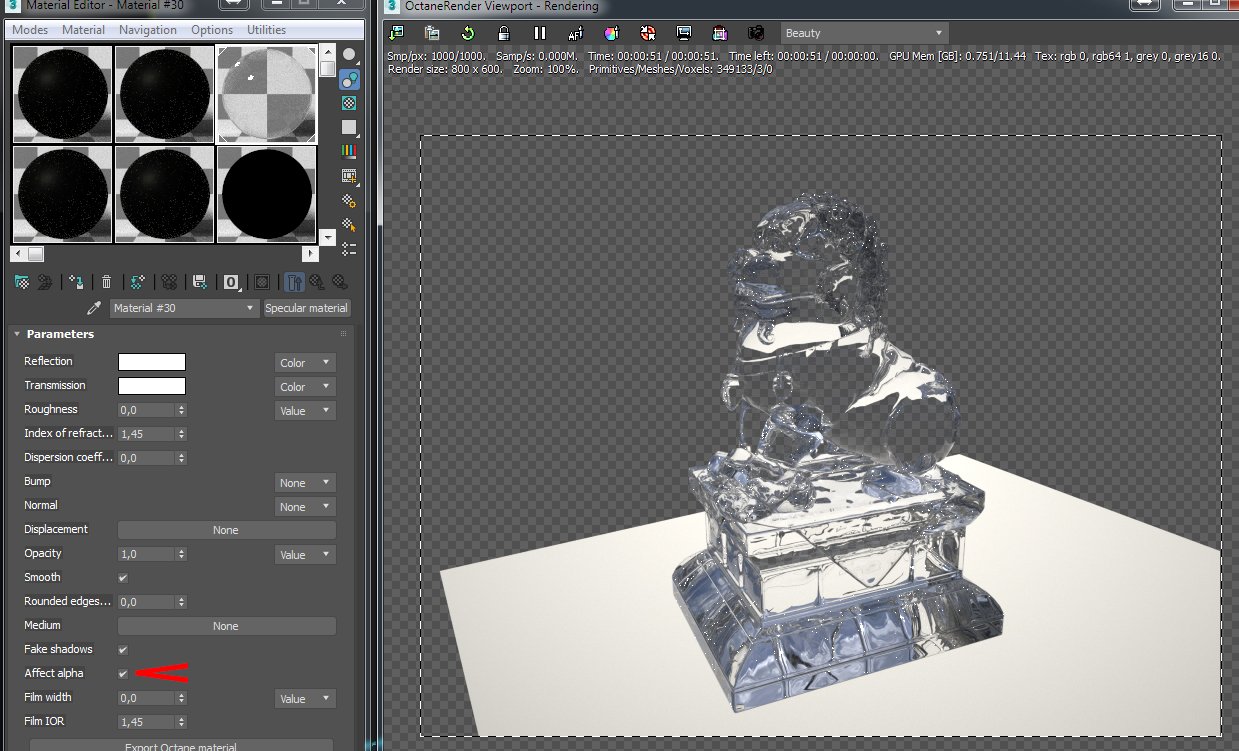

- did anyone have hard time connecting to network render - mine says wrong version, while I did have the correct one loaded onto the other machine - all the version numbers look OK.. unless there's a build number as well..
- also a feature qestion:
Specular material - is there a way that it actually shows up as transparent alpha when you save in .png - so far it only seems to work when there is some opacity - not actuall transparency from glass - alpha apparently treats the transparent materials the same as a diffuse one -

Oh sweet - damn, I was looking at that button and I was thinking it was to do with the opacity setting only - was looking for thatparide4331 wrote:Hi acc24ex,
Did you install 3.06 Octane Stand Alone?
With 4.32_3.06 you need Octane Daemon 3.06.
About alpha, you have to check "affect alpha" in specular material.
Regards

Hi Elvis,Elvissuperstar007 wrote:Converter does not work Vray to Octane , I get the glass
Here is the scene
Thanks for the scene and report of this issue.
The current converter creates a Specular material for materials having some refraction, and the diffuse is ignored..
This will be fixed in next release, using a Mix material for those cases ..
Current workaround is to clear refraction before conversion, or change to a mix material after conversion, and re-assign a diffuse and a specular ..
