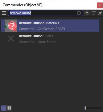

Hello, I can't intercept CallCommand for "Remove duplicate material". It intercepts the one for "Convert Materials" but not for the removal.
Any chance anyone here knows what the ID on this CallCommand is? Thank you!

[quote="Hurricane046"]Hello, I can't intercept CallCommand for "Remove duplicate material". It intercepts the one for "Convert Materials" but not for the removal.
You can look for commands in Commander(shift+C)
ID_REMOVE_UNUSED_MATERIALS=1035351
ID_REMOVE_DUPLICATED_MATERIALS=1036468
Hurricane046

Thanks for the answer! Unfortunately it seems that Remove duplicate material isn't your average Python c4d.CallCommand().
Remove Unused Materials
c4d.CallCommand(1035351) does work.
c4d.CallCommand(1036468) doesn't work.
I cannot even find the "Remove duplicate material" Octane function in the shift+C list. It only shows these two where one is the Remove Unused Materials function and the other is my Python script.
Is there any way this function can be called via Python script? Out of 30 various functions we've already implemented, this one is throwing a wrench in the whole thing. :?
