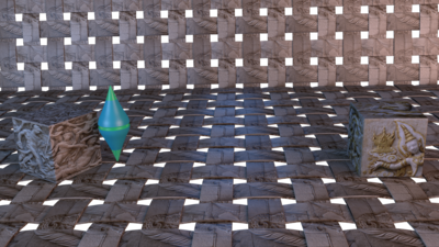

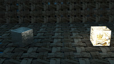

@ steveps3: the new exporter allows to control all materials of the internal graph from blender (limited to basic drivers such as floattexture/floatimage/image/alphaimage, but for all channels - diffuse/specular/roughness/bump/normal/opacity/emitter). There's little benefit for static images as you should tweak materials inside Octane, not Blender. On the other side, with it you can animate anything from blender, including material type and all parameters from Mesh Preview Environment and Mesh Preview Kernel. It still allow to work the 'old' way, may be just with less accuracy when exporting through MTL (no specular for instance). But once again, this doesn't really matter for static images.
WIP "Next-Gen" blender unofficial exporter
@ tungerz: well done! nice to see you can get something out of it

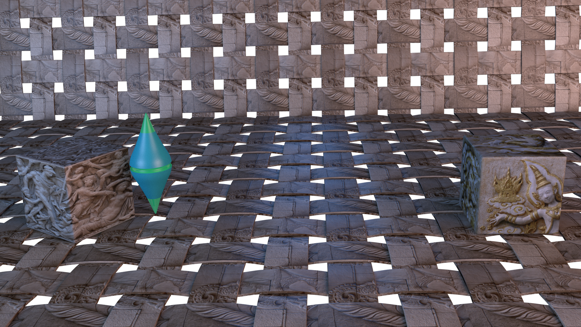

Yoyoz octane exporter 1.08
blender 35311
Octane 2.44
Q6600, 4gig memory, 32bit vista, geforce 9600
Alpha channel gave wierd artifacts,this is 2.44 may be something the Refractive crew needs to look in to, dunno.
Some textures didn't seam to give the effect i was looking for, the single static renders came out different than the animation renders, I attached the single frame renders also, I have to look into it to find where I goofed up the textures, but anywho my error, not the exporter :p
10 sec clip at 512 samples/pixel took only, 1day14hours31minutes to render :p
