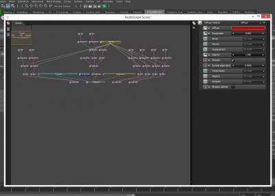

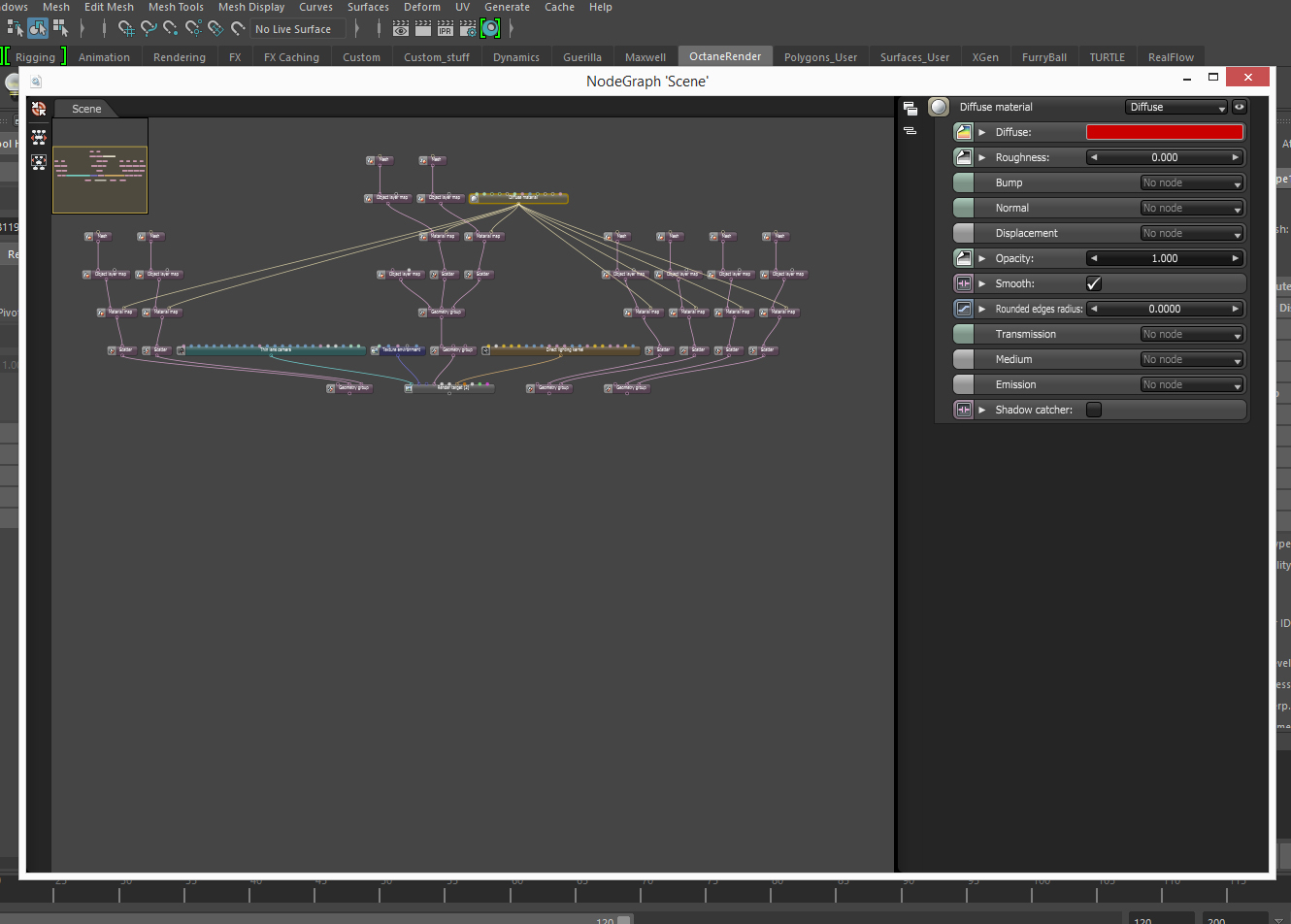

Just found the ? button on the octane shelf.... I am excited to see direct access to the stand alone interface, however, when adding just 2-3 objects then opening the interface, the graph is loaded with a ton of nodes right off the bat. nearly impossible to navigate.... I found this to be the case when exporting a scene with the old plugin also.

Doing some experimenting, when applying a material in the standalone window, then leaving it, it updates the render view. However, when refreshing, all of those nodes are disconnected. Reopen the standalone debugger and the nodes are there, just disconnected.
