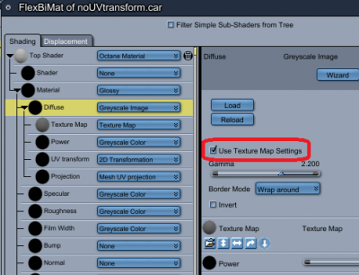

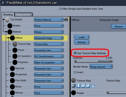

If you look at an octane image node (not the texture map) you will see a setting called 'Use Texture Map Settings'. When this checkbox is enabled then the settings from the attached texture map are used instead of the Octane ones. If you want to use the Octane transforms then you need to disable this checkbox.protovu wrote:Hi Simon,
I have a material which is not allowing any Octane UV transform. Oddly, it does allow Carrara UV transform.
The same crosshatch bitmap does work in other Octane Materials. I will work around, but would like to know how to correct the existing Material instead of swapping it out.
thanks for your help,
Rick
The following Octane settings are ignored when 'Use Texture Map Settings' is enabled:
Border Mode
Invert
UV Transform
Projection
