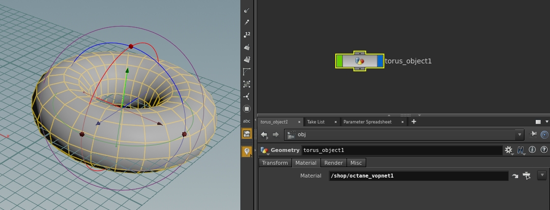

Does the plugin not be able to use octane material creation for OS X?
Followed the BW video and did the following:
- create a sphere
- create a oc network node (vopnet1)
- drop the node onto the sphere for assign the material
- jump into the vopnet node
- create a glossy node and connect to mat out
- change the color in the glossy node
- hit IPR button
- still no changed color - only the pink color is shown
If I create a standard glossy material node instead the vopnet then I can change the color (material).
Do I something wrong or is it another bug of MPlay? In this way I would not be able to create a single
oc material inside houdini.
I saw in the BW video that he is changing the color inside the vopnet, but the object in the viewport
is still white. So is this normal to all oc vopnet materials - can we only see them in the IPR?

Sometimes the drag an drop vopnet nodes over the objects in the viewport doesn't work. This is known limitation of the Houdini HDK that I am not sure to fix, and that I've seen also in other render plugins.
Please, check that you have the material to be used set in the object node Material tab.
-Juanjo
-Juanjo
